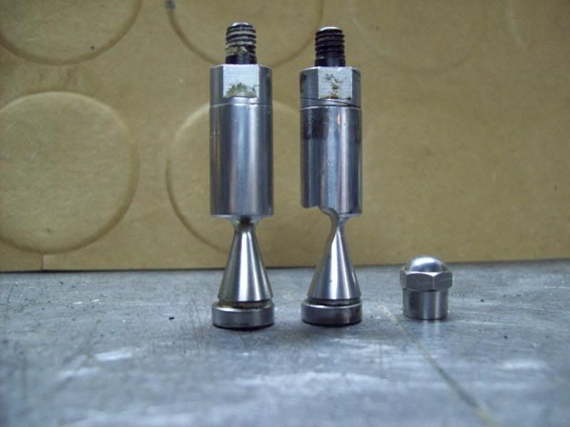

on topic:I ground a spare fuel pin and this pin madea bit of a differance,more power from a rotated stocker,but with my WMO mix it smokes tomuch for my likeing.The truck has the stock(rotated)oin back in it now and I prefer the stock pin.
In Hind site I would have left the bottom alone,and would have come up about 1/4" then started my steeper ramp.It just fuels to much to quick and smokes like a bastard when gettin the load going.Soon as im up to speed and spooling it made great power and smoke was fine...to much fuel to fast on the bottom end IMHO.

Yep, a ground stock pin allows full fueling. But, an aftermarket pin is a bigger diameter at the base which helps with lost boost fueling.
