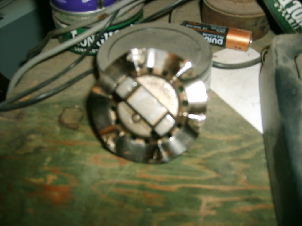

I just tore my pump apart getting ready to rebuild it and got into and the cam plate has been beat like no other on 4 of the 6 lifts does anyone have a camplate roller assem. they want to sell or can get me a pump core for these parts need them ASAP pump has to be put back together and in the truck within 2weeks

i have a stock cam plate you can have,
throw some pictures up i would like to see the ware

The plate would be greatly appreciated tell me what I need to do im not to good at pics but this is what I have for ya it chipped off 4 of the 6 lobes on it but I could use the stock plate and they have a kit for new rollers but as well come to find out today I need to get a transfer pump as well...lol its my luck never would have doubted any of it
I cant wait for you to see the pictures. Them lobes are not worn they are gone. OMG!!

was there dirt and crap in your pump when you puld it apart, and second were do you live, im wondering if you fuel volosicty is difrent, oh and how many miles on the truck
