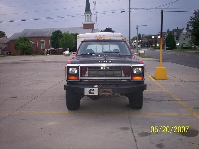

Postby RumbleFish » Sat Dec 27, 2008 5:52 pm
the IC will fit behind your grille with some trimming.
this is the stock 83 grille infront of a banks IC. the PO was responsible for this. he sure couldnt wire anything to save his life though. it looked decent.
if you dont have a dremel, get one. i wouldnt trade mine for anything, i use it constantly.
