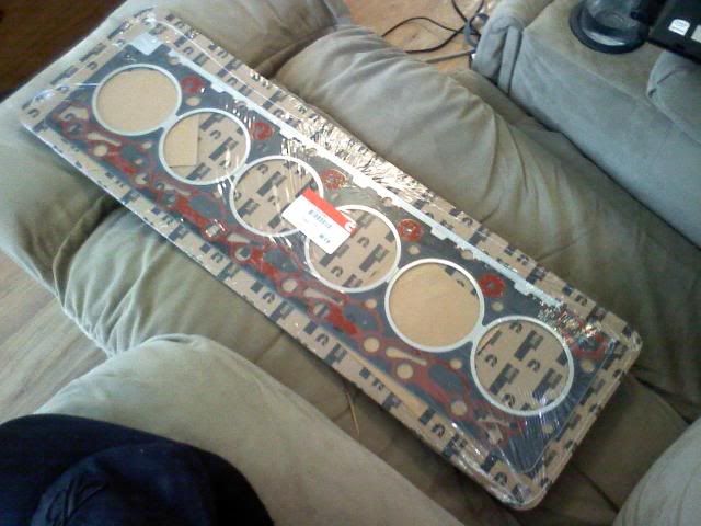

Postby RSWORDS » Mon Apr 27, 2009 1:41 pm
Guess its a good thing this showed up today!
RSWORDS
