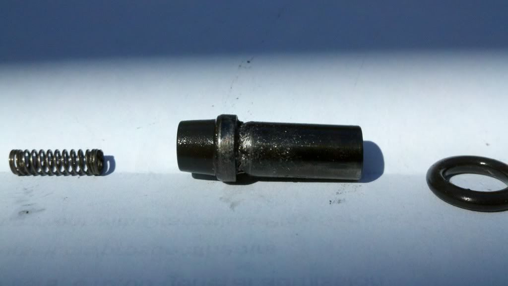

Postby IowaCummins » Wed Jun 08, 2011 3:43 pm
was the fuel shut off plunger broken? like the rubber tip missing? i chewed up two of em and i pulled my delivery valves and cleaned out a few little chunks of rubber just sitting in them.

Postby scotts_d250 » Thu Jun 09, 2011 2:10 am
I saw metal shavings on the shaft of the plunger and the rubber tip was complete. I thought the shavings were from the solenoid it looked like the o-ring stopped most of it.
