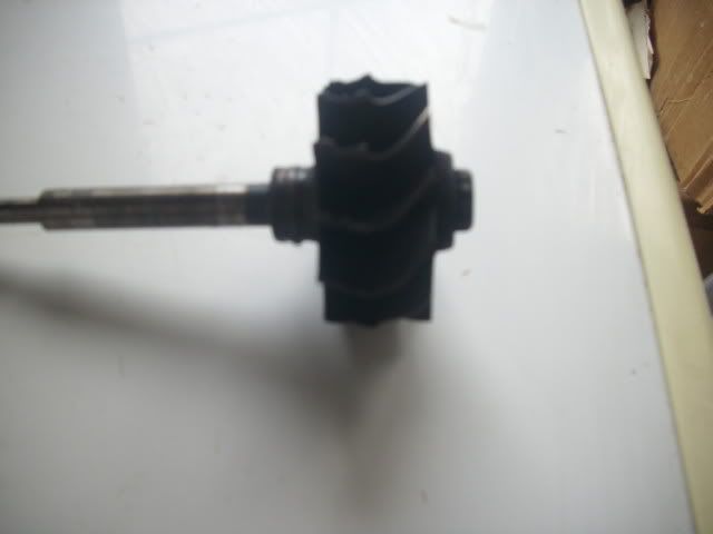

What's the HISTORY on your turbo?
Was it on a good running engine prior to your acquisition, or was it off an engine that needed rebuilt?
The HE351s and their variants (HE341 or HY35) have a really tight tolerance on the turbine housing.
Commonrails LOVE to burn up pistons and rings and send the shrapnel through the turbine, which destroys the turbine's inducer.
For this reason, the 1st thing I do is split the turbine housing from the cartridge to see if the turbine is hacked.
Below is a pic of a turbine from a turbo where the engine "just" lost the rings:
Re: 89 12v, very smokey and low on power, any ideas ?
Postby PToombs » Sat Apr 21, 2012 5:23 pm
I think that's missing the edges of the wheels a little bit!

Yeah, mine is in the same shape, I went ahead and ran it anyway for now and plan on getting a new turbine later.

Postby Mark Nixon » Sun Apr 22, 2012 9:39 pm
If your turbine looks like that, there is no way it's nearly as efficient as it can be.
Go on Ebay, type in "HE351CW" in the search, pay the @ $130 they want for a turbine and grab an HX35 rebuild kit and fix your problem.
