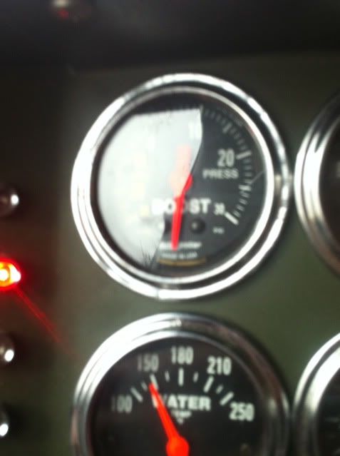

Here's my HX35
Ported the intake crossover too for a little more flow. Wasn't hard to put on. I welded the wastegate shut. You can also use a WH1C off a 1994-1996 ram as they are basically the same as an HX35 but with a clamp on style compressor.
Also, take the compressor housing O ring out and put a bead of silicone in there instead. Worked for me and the turbo spools twice as quick now. Just make sure you don't have shaft end play as if there is too much it will rub :sad:
Here's the boost gauge this morning....pegged
