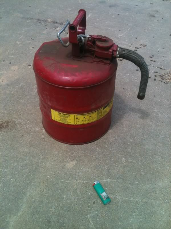

Looks like I've gotta trash pile burning back there :lol:
No air bubbles in the fuel, its kinda acting like a timing issue at this point. Like something inside the pump has bellied up on me. I'd hate to think it was an injector problem as new as they are,of course I don't know how all 6 take a crap on me at the same time to cause the low idle. :|

? :bom: fixin to use tacoclaws mod on it

Re: Dodge Down,screwed up symptoms
Postby Tacoclaw » Thu Aug 30, 2012 6:27 pm
Got it ready for you, Ellis:
I'm looking for a place out west to take a bike trip to this weekend, should I drop these off? If nothing else it sounds like you could top off your tank with the gas. ;)
