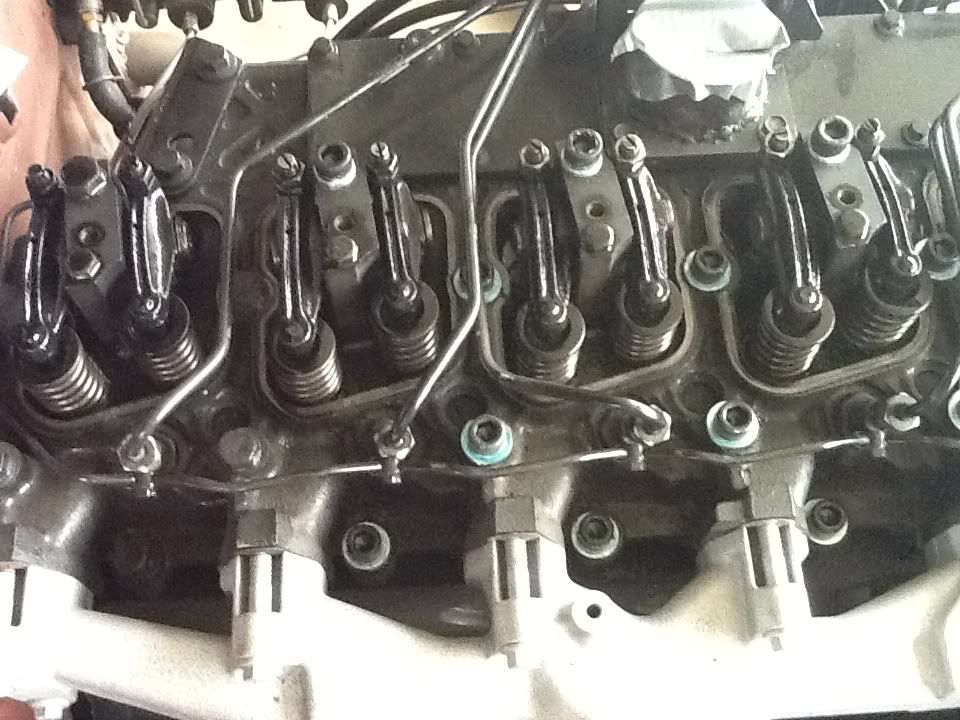

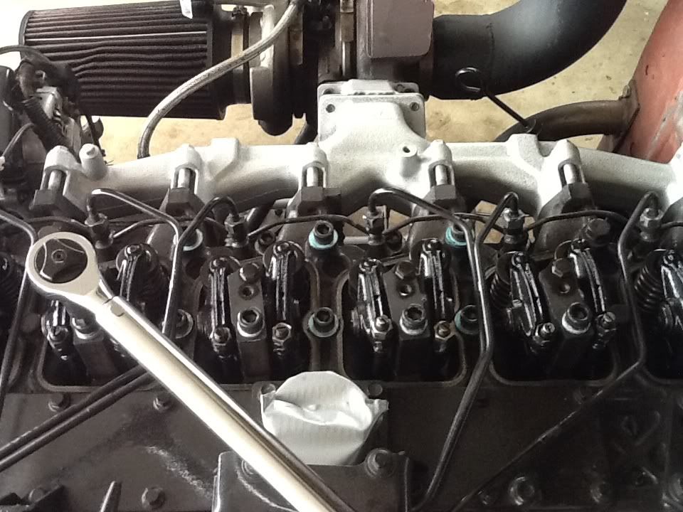

This was about halfway done, still some stock bolts in there.
I got into a wreck a few days ago, since I'm waiting on parts for that I did this and adjusted valves while I have the covers off.
Install went well, bolts seem a lot better then the stockers and now I won't worry about 40-45 psi runs.

I dont wish to spoil your party, but the rocker covers will leak like a sieve with the washers on the bolts between them. I put bolts similar to yours on my truck and had to eliminate the washers in between the rocker covers. Just make sure the bolts dont bottom out. Or grind the washer to the same dia. as the bolt heads.

Can also just grind down the webbing on the inside of the rocker covers, if in fact they do leak.

Actually looks like they might leak! You might wiggle them around to see if they will seat around the washers.

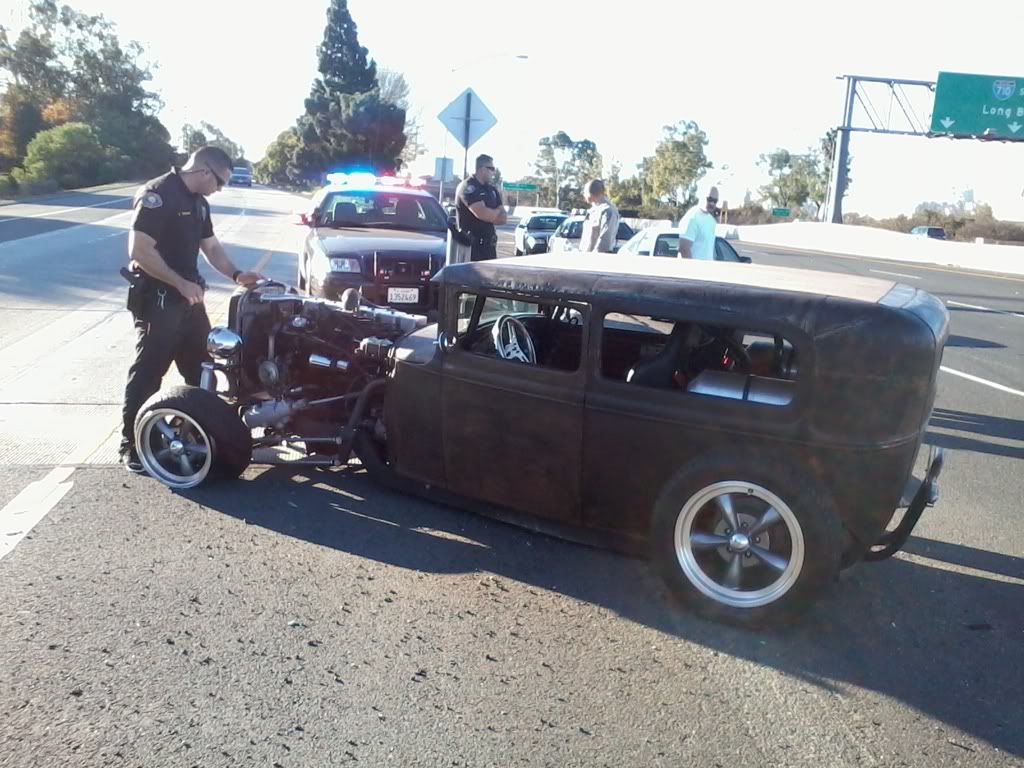

Only have one on my cell phone, some a$$ cut across 3 lanes, spun me out at about 70 mph and I went up a curb sideways. Only damage was front rim was trash, and bent a spindle. Made me glad I put a cage and 5 points in, 70 backwards on the freeway wasn't as bad as it sounds

hemislave wrote:I dont wish to spoil your party, but the rocker covers will leak like a sieve with the washers on the bolts between them. I put bolts similar to yours on my truck and had to eliminate the washers in between the rocker covers. Just make sure the bolts dont bottom out. Or grind the washer to the same dia. as the bolt heads.
I defenatey thought about that after I put the first one in, I haven't ran it yet but it seems like the sealed. With my luck I'm sure it will be a fountain :D :D

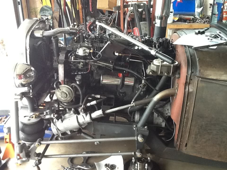

Here's how I ended up...good thing about having an open wheel car is the wheels take the hits first!!!!

The cop is thinking, "how the fock did he get that in there?" :lol: As low as it is there's not much chance of rolling over anyways!

I'm really glad you are alright... and the rig.
Nah, the cop is thinking... what a breautiful lift pump on the side of the block. LOL
