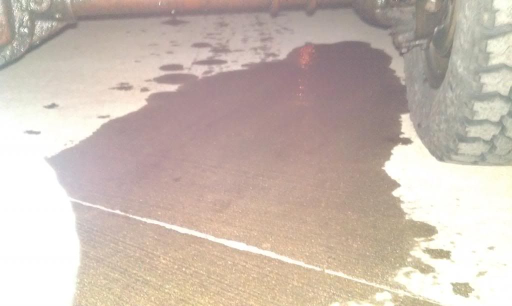

I was driving home the other night and my injection decided to spring a huge leak. In less than 10 miles i dropped a 1/4 tank of fuel on the ground and all over my truck.... Looks like its on the back side of the injection pump maybe where that little plate is. Anyhow it was like having a pressure washer of diesel fuel in there. Fuel got all over the engine fender, firewall, and all over the undercarrage.

might of popped the oring to the head. either way that sucks because diesel cost to much to wash the engine with it..

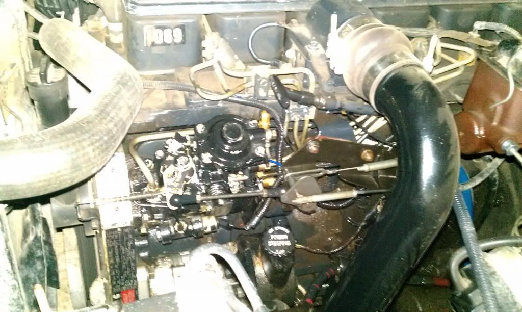

When it was running, could you spot where it was leaking? Otherwise, time for a reseal, and check all of the fittings/lines too, something might have cracked...

I remember ptoombs having an issue,or talking about it,with one of the o-ring on the advance pistons bore covers having blown out. Could be your issue

Most likely your mess is from the rear timing piston cover, just pull the pump and do a total re-seal.

I thought that was my problem. I pulled the pump, removed the cover, and the o-ring looked ok. I replaced it, replaced the front seal and put it back on. I ran the truck for a few days and noticed a leak again. I finally tracked mine down to the timing plug in the head was slightly loose. :roll:

Yea it was spraying out the back side in the middle guess where that plate is. It sprays out pretty good when I turn the lift pump on and really sprays when its running. Anyone know of any really good detailed write ups on a reseal? Gonna need it when I tear into it.
