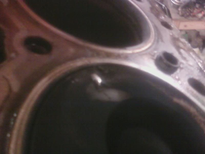

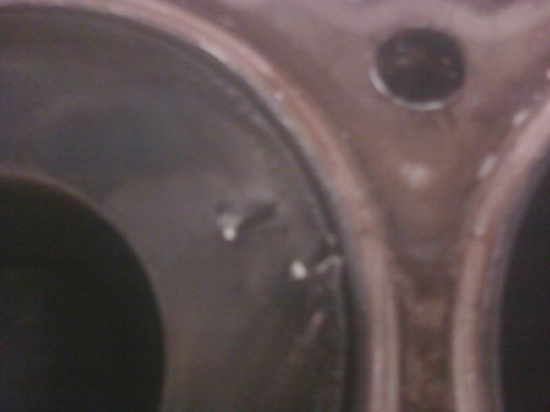

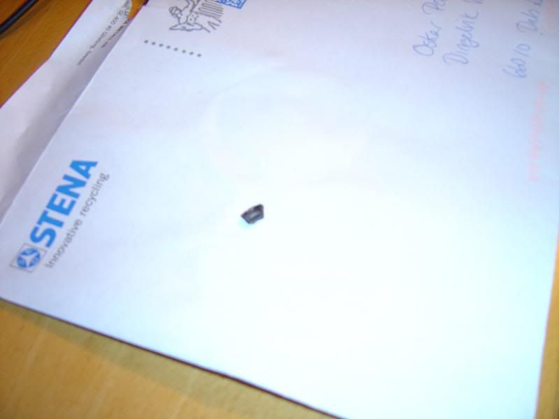

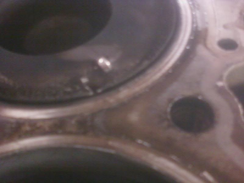

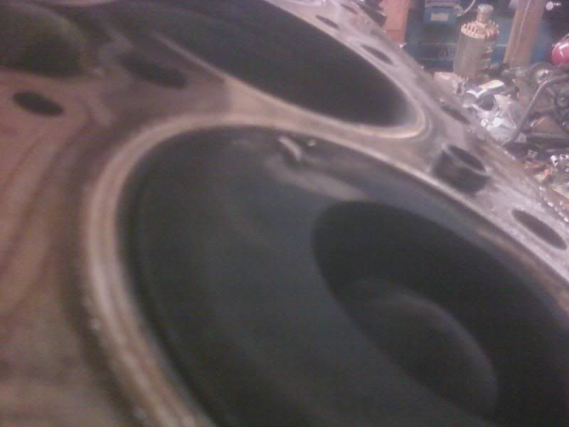

Hi, Just want to let you know that i found the fault, some kind of metal piece (looks like a piece of a steel washer)
got sucked into the engine and smashed into #6 piston, hopefully the piston is OK if i only remove the piece and grind away any aluminium burrs.
but i need to find where that piece came from! it looks like some hard steel piece, like a bit from a piston ring, but it can't be a ring since there isn't any scratches in the cyl. walls at all..
took the turbo apart but no parts are missing there, will try to check the intercooler too.
here's some pictures:

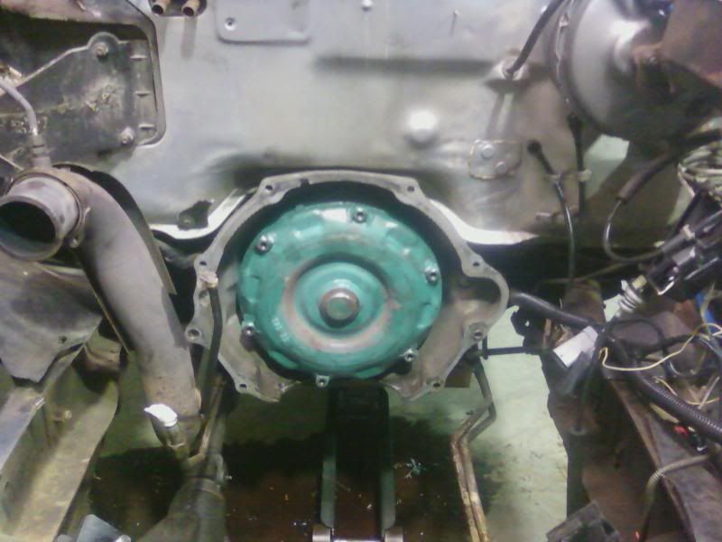

Also, another question, does somebody know what type of converter i might have? it's marked "11 161" and nothing more, the tranny was rebuild at Bob's Transmission in CA, and on the reciept it says only "replacement converter"
At this time it's a good idea to change the TC if there are better ones on the market, only thing i have in mind is fuel economy and low RPM's at highway speed (70mph in Sweden), so a lower stall speed is appreciated (also helps to keep the fluid temp down)

Postby RCCUMMINS89 » Sat Aug 03, 2013 10:56 pm
Hard to see, the pictures are blurry.
Not piece of the h/g by chance is it? I've seen that before.
Otherwise nothing comes to mind.
Re: Did a burnout, got engine knock...
Postby Oskar » Sun Aug 04, 2013 2:27 am
It's not the head gasket either.. took a picture of the metal piece too: Image
