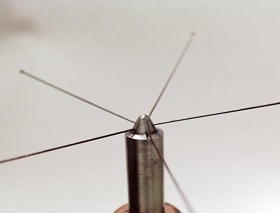

Also, the injector spray angle, how do I find that out?

Philip had a pic someplace of a tip with needles stuck in it, showing the angle. I don't know how to figure it. :oops:
Postby Philip » Tue Mar 18, 2008 5:33 pm
You mean these two pic's Pete.

Postby Philip » Tue Mar 18, 2008 6:43 pm
The top pic is a VE tip. The bottom is a 2nd gen tip.
Postby PToombs » Tue Mar 18, 2008 7:01 pm
Yup! Them pics! ;)
Postby ford69557ci » Tue Mar 18, 2008 8:07 pm
I could be wrong but i think the first gen tips spray angle is 145??
