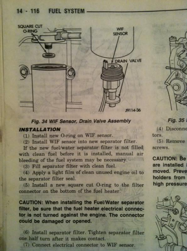

Postby slow_90firebird » Tue Dec 17, 2013 12:07 am
heres the o-ring i was asking about. It comes with the new filter along with the round one for the WIF sensor. I always changed the one on the WIF sensor, but then I threw that other one out! I had no idea where it was supposed to go...

Postby PToombs » Tue Dec 17, 2013 6:15 pm
Oh, yup, that one! Sorry, I forgot all about that bugger! :oops: That's to make sure the dirty fuel doesn't take a shortcut and bypass the filter.
