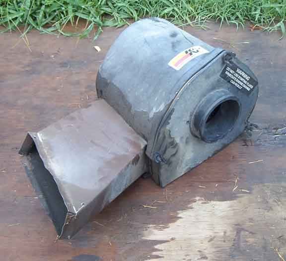

If not making more than around 300hp, the best way to do it is open up the stock intake and extend it through the front valence - true cold air intake. The stock filter is rated for 450cfm:

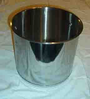

You can replace that stock/OEM air intake muffler with something bigger for a tremendous improvement over stock . . .
Or get a soup pot,
whittle on it some . . .
And sneak that boy in the OEM location.
Postby Ace » Fri Mar 13, 2009 11:57 am
BC847 wrote:You can replace that stock/OEM air intake muffler with something bigger for a tremendose improvement over stock . . .
That's a portion of my cold air upgrade as well.
I'm going to do the stock pot thing if I ever need to go to a BHAF.

I saw this pot job :lol: you did friday and sat I was at Big lots, A local close out store, and saw one with a small dent in it for 10.00 bucks. So guess what I am working on for my BHAF ;) Thanks for the idea, cool as all get out.
