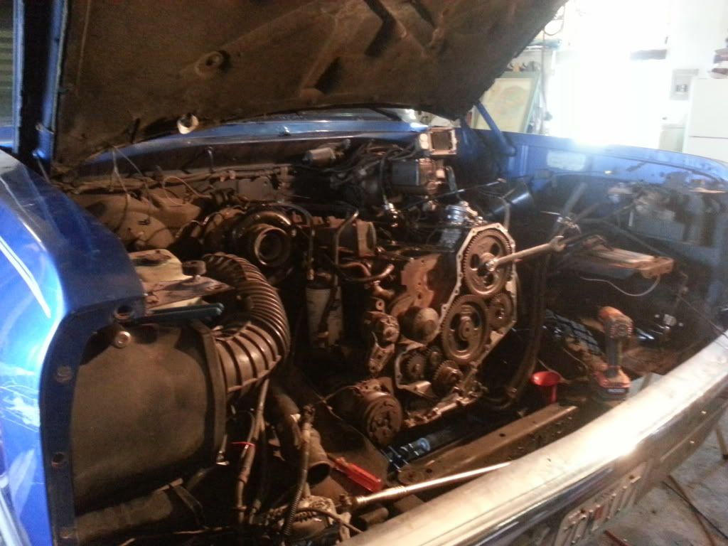

thank you men .but its kinda discouraging because this is what she looks like<a href=http://s1285.photobucket.com/albums/a596/goldpannerhager/?action=view&current=20130502_082859_zps20f4bd43.jpg target=_blank><img src=http://i1285.photobucket.com/albums/a596/goldpannerhager/20130502_082859_zps20f4bd43.jpg border=0 alt=></a>

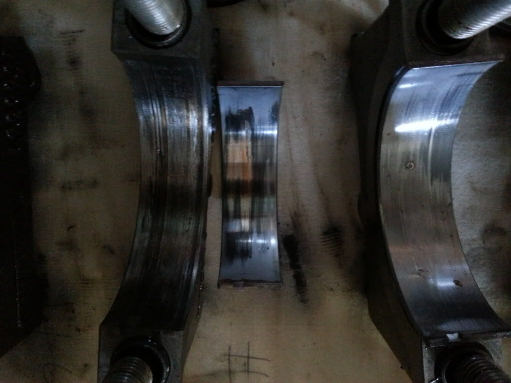

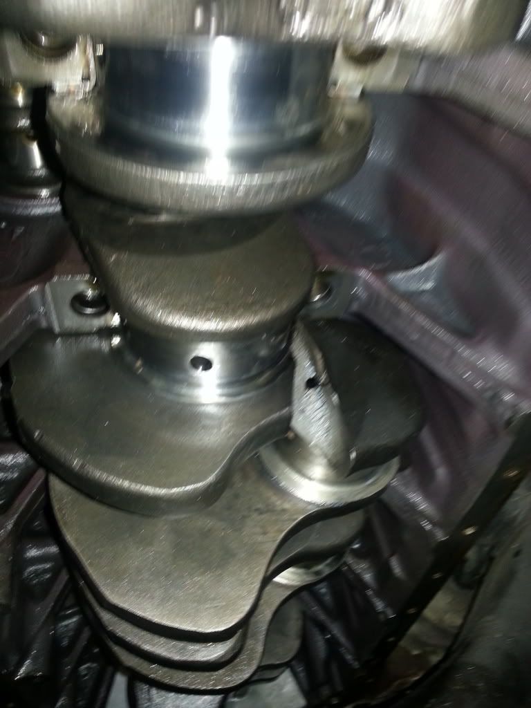

okay so I found the real problem to my truck I just now pulled the crankshaft out and found the crankshaft is completely broken in two what the heck how could I have broken my crank should I look at something else and see if something caused it

Postby RCCUMMINS89 » Sat May 04, 2013 7:20 pm
Your crank broke? AND IT STILL RAN?

Postby ellis93 » Sat May 04, 2013 7:23 pm
:worthless: :worthless: :worthless:
Damn it man post up those pics

Postby hager » Sat May 04, 2013 7:42 pm
yeah it ran I drove it up on a trailer and then I drove it into my shop I didn't think it was that a spun bearing could make that much noise but I never had an engine that spun a bearing so I just assumed that it would make that much noise. does all that make sense?

Postby hager » Sat May 04, 2013 7:46 pm

Postby ellis93 » Sat May 04, 2013 7:47 pm
hager wrote:http://i1285.photobucket.com/albums/a596/goldpannerhager/20130504_213249_zps84d20e90.jpg
Holy Schit :lol: that's crazy!

Postby dazedandconfused » Sun May 05, 2013 5:10 am
Check with Mark Nixon he may have one. Make sure you have that block checked out well and magnafluxed.
