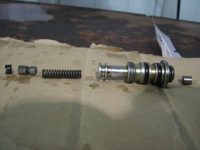

also i pulled a part the regulator on the pump
this is what it looks like when apart

hey KTA, or anybody when i got the truck running my case pressure went throught the roof, i hit 320psi, then i shut the motor off, im assuming it has somthing to do with the KSB being removed, any thoughts, and what did you mean by having to change something
what was really cool though, as the case pressure went up so did the timming and you could hear the motor run better

Postby KTA » Sat Apr 05, 2008 6:21 am
The timing piston is diffrent between a ksb pump and a non ksb pump. By removing the KSB you took off the bypass that essentially makes it like the ksb is on all the time. I will have to look in the book at the circuit and see but I think you might have to drill an orificed hole in the timing piston.

Postby cummins king » Sat Apr 05, 2008 8:41 am
okay thanks it would be much apresiated because whats happening is the case pressure just steadly goes up and i hit 320psi and im sure it would of kept going, so its not being regulated back, with drilling in the timming piston you just drilling a hole right through it, or......
