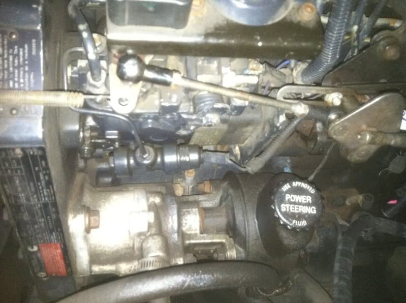

Just so you know what you see in your pic is the ksb. The fss is between the pump and windsheild. Ksb is between the pump and driver side tire. Lol good reference points hu? ...

The connectors I was questioning can be seen in the pic just above the end of the TV cable. Blue wire.
The lever I am trying to use as the manual shutdown is the one in the picture just above the connector to the "ksb".
I need to play with it some more tomorrow, im probably gonna order a new shutdown solenoid on ebay I found one cheaper that works on cummins, VW, MB diesels ect. Also might order a pump seal kit...
So if I remove that bolt or nut holding on the shutdown lever, what is the best method to properly index it?
