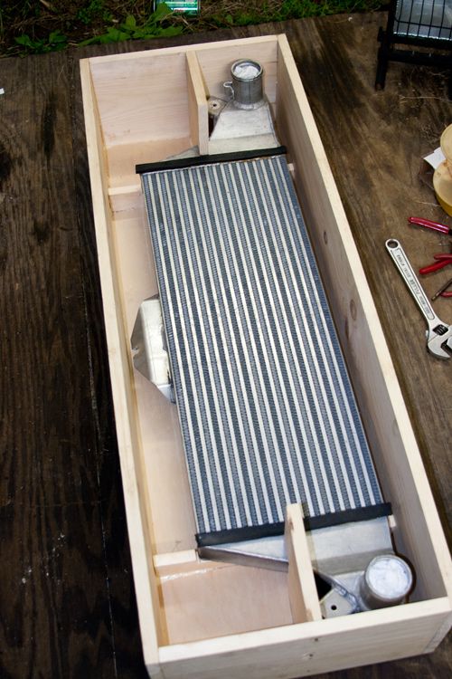

Postby BC847 » Tue Mar 20, 2012 5:25 pm
I had one of those ICs. It's a very good unit for what it is. 8)
