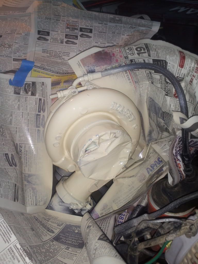

Found a can of Cummins Tan at Tractor Supply and decided to to some engine bay beautification.

Postby dieselcountry85 » Thu Jan 31, 2013 5:12 pm
I taped the Holset so they will still be black.

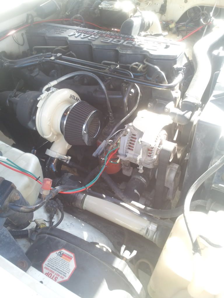

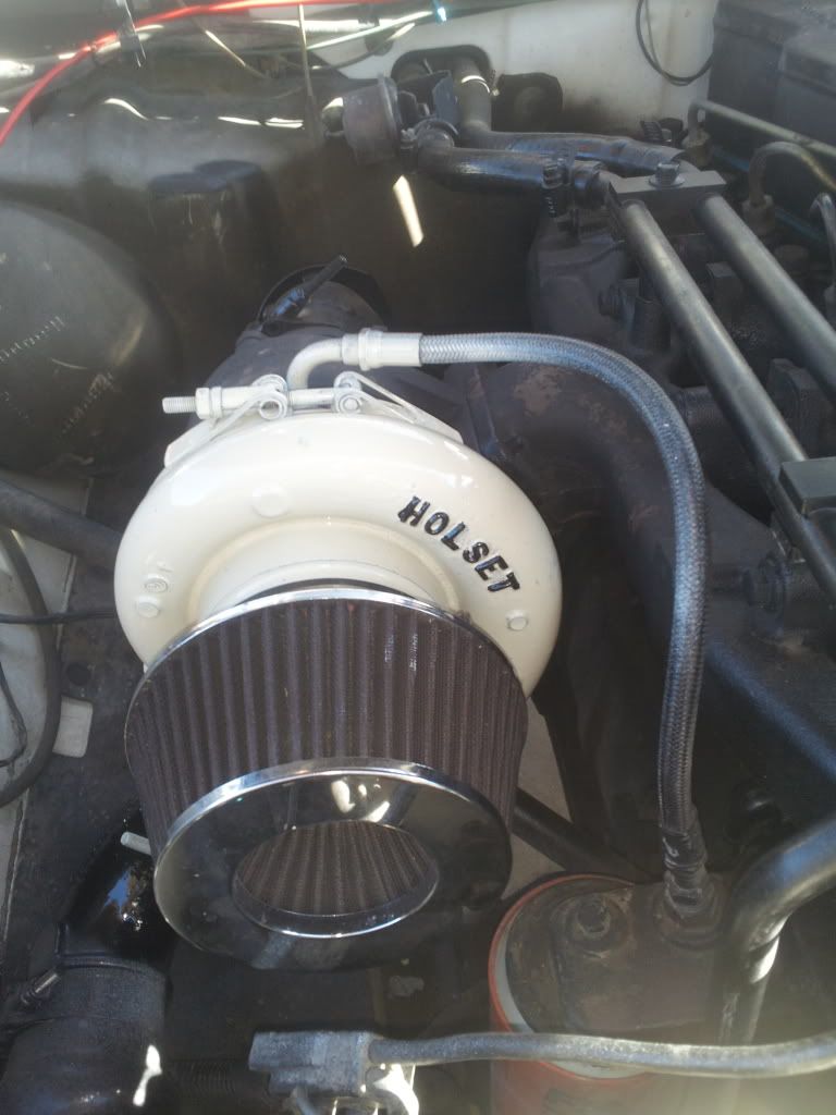

Postby dieselcountry85 » Sat Feb 09, 2013 3:26 am
There, that's done. Took awhile to upload pics.

Postby PToombs » Sat Feb 09, 2013 6:21 am
That's a cool looking little air cleaner. I see 2 problems with it though, it sucks hot air from the manifold, and it's not big enough if you work the truck hard. If you just drive around town it's probably ok, but if you pull a trailer or hot rod it you may suck the seals out of the turbo from too much restriction.

Postby dieselcountry85 » Sat Feb 09, 2013 12:16 pm
Pete, I am in the process of putting together an intake. still considering twins too...
