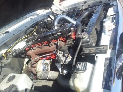

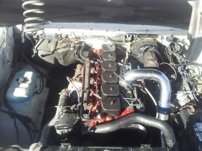

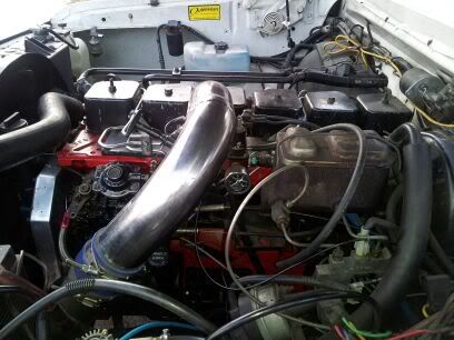

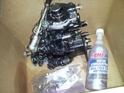

Postby xohcef » Thu Mar 07, 2013 11:17 am
Pump
Engine bay shots

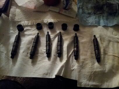

and a pic of the extra injectors I have if some one can just eye ball em by experience. I'm currently at work and don't have them with me or else I'd just measure.

Postby cmann250 » Thu Mar 07, 2013 11:24 am
I think you have a non-intercooled pump, because it looks familiar to me, but I could be wrong. You do have intercooled injector lines and you can tell what injectors you have by the number of holes. 4 holes=non intercooled, 6 holes=intercooled and both situations assume they are stock.

Postby cmann250 » Thu Mar 07, 2013 12:19 pm
After a closer look, you have an intercooled KSB on the side, but from the angle, it looks like a non intercooled pump because of the short delivery valves. You do have an intercooled thremostat housing and radiator setup. Does the vacuum pump have pods on the side and bottom, or is it a vane style?
