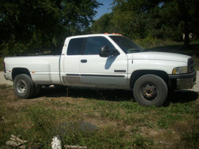

Oh, believe you me, I'm REALLY kicking my ass for selling the 2001 E/C, 2WD, Dually, 6 speed I bought for $2800 last summer. :evil:
Had a beat to hell bed and a bad passenger's door, found a nice WHITE bed on C/L for $300 and had a decent door IN COLOR (white).
The tranny scared me, got to shifting hard and got me nervous, so I dumped it for 5k, then later realized I should have dropped the oil and overfilled it prior to getting nervous. :cry:
It was candy, candy, candy, full power, leather, sport package, radio with CD/Cassette, even had the factory anti-theft with the alarm set light in the OH console.
Here it is AFTER the bed and door were installed:

That's a good looking truck Mark.
Re: 1st gen vs 2nd & 3rd
Postby Mark Nixon » Tue Mar 19, 2013 1:41 pm
CumminsPower59 wrote:That's a good looking truck Mark.
Dammit! I know! :cry: :cry: :cry:
