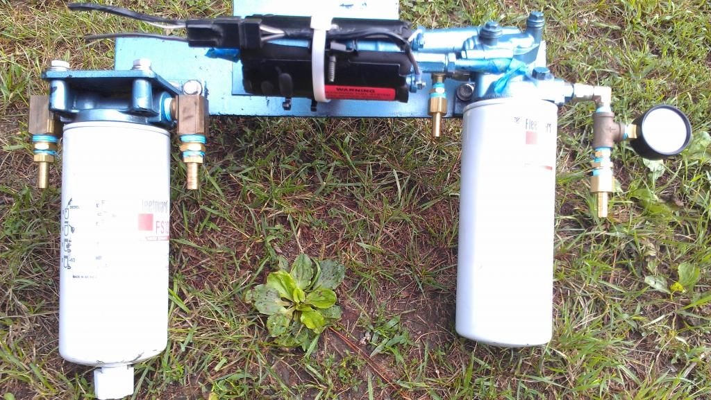

I have a electric fuel setup for my old powerstroke, which uses a 99 and up electric stock fuel pump, and fleetgaurds: fs1000 water seperator and a ff5319 high efficency 2 micron. I built it for my powerstroke first LOL, but took off before the sale of truck. Can I use this style pump with a VE pump and if so what do I regulate the pressure to?

15 psi is safe. Too much will push out the front seal.

Ok awesome, keeping that setup around then :mrgreen:
