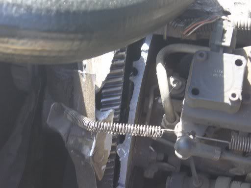

Postby RedneckCumminsLover » Thu Feb 27, 2014 10:25 am
i recently blew my injection pump gear in half and shot it out the casing and ive been having a hard time figuring how it happened because I just turned the key and bam!! im also having an issue locating a new casing and gear
ideas
thnks

Postby Philip » Thu Feb 27, 2014 5:41 pm
It has happened to other people also. No one has figured out why.
Check your camshaft. Most of the time when the gear goes threw the case. It will break the camshaft.
Now for the worse news. If the camshaft is broken. It most likely has bent every valve in the cylinder head.
So do some checking of the camshaft. If it is broken it will come in cheaper to find a running VE engine used.
It kind of looks like this pic I bet.
