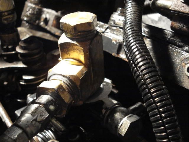

just drill and tape. or if you remove the afc then you can plug it or do what i did, cut the whole pump top ofImage

Just drill and tap it for 1/8 NPT and then use the hole just under the intake horn that has a plug in it. This gives you more room for the line to bend and makes top removal alot easier since you don't need to remove the line if slack is provided.

Tap it to npt, (pipe thread), then use plastic air line and fittings. The head is npt already.

National Pipe Thread, or, wait for it........ pipe thread. I have a valet in mine, so it's weird looking.
Postby TWorline » Mon Feb 18, 2008 6:46 pm
The drill and tap is an easy fix, I used brass fittings and 6" of big truck 1/4" air line to fix mine. It cost about $10.00 total the new metal line from Ma MoPar is around $60. You can see it in this picturehttp://www.turbodieselregister.com/photopost/showphoto.php/photo/1753/limit/views

I THINK I have a stock AFC setup. I know for 100% certain I have a banjo bolt or two removed from previous vehicles. They're yours for shipping ($2 or so). Or just do what I did-
Get the following from a semi truck parts house-
1/8 OD airline union
1/8NPT to 1/8OD adaptor (elbowed is optional, but makes it look neater).
6" of 1/8OD tubing
Take the ferrule and compression nut off one end of the union and put the union in the AFC housing. Perfect fit. Install the 1/8NPT-1/8OD adaptor in the head. Install the tubing, and VIOLA, functioning AFC again. Some have reported a slight loss of acceleration, others havent.
