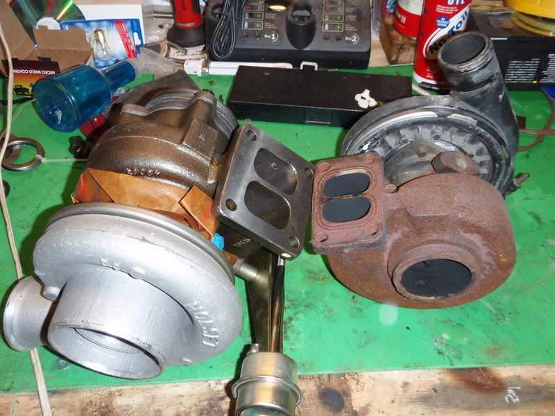

ok guys i got my WH1E back to my house today. and.... noticed the exhaust flange that bolts up to the manifold is alot larger then the standard 5.9 turbo. so what do i have to do to mount this thing up. do i need to fab up an adapter plate? or do they make one? or does some one make a new turbine houseing for the WH1E (hx40) that has our style flange on it?

CK, not all HX40's were mated to an exhaust housing that had a T3. Yours may have been but he has a T4. I think HTT has adapters. I would call them or build your own. And besides, I would say that most HX40s made were for the 6CT or 8.3 Cummins which has a T4 manifold.

ya mine is off of a 8.3 so im guessing its got a t4 flange. well i'll see how much htt wants, but im probly goin to fab one up. think i got a plan goin in my head. but what i realy need is a mill and a chunk of aluminum. i'm goin to start on it tomorrow. tonite party nite. so i'll keep ya updated with sum pics. thanks guys

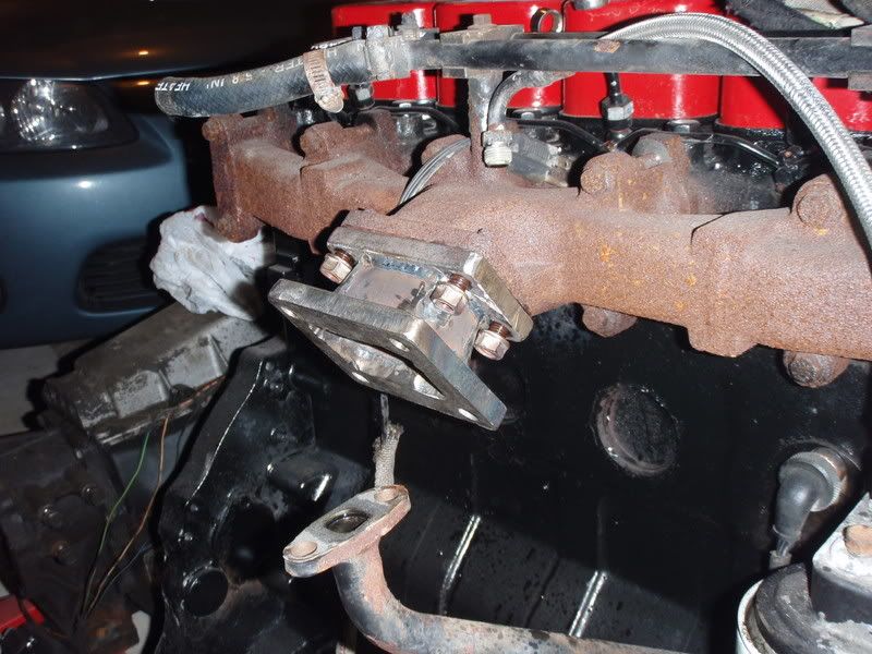

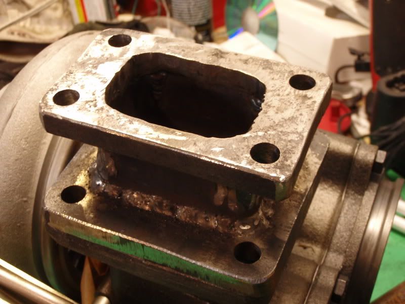

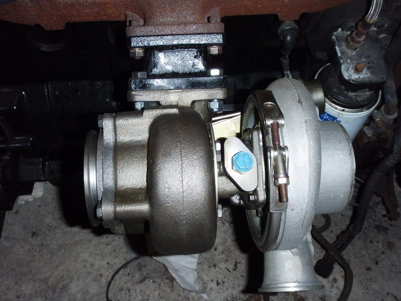

ok guys made me up an adapter today. only took me about 5 hours. alot better then dumping 150 bucks. well here sum pics of it. let me know what u think. i plan on tapping it for pyro, and adding a few ribs to it for extra support. i do jump the truck, so i dont need that thing ripping off
ya i knew the aluminum would be a bad idea, was just talkin out my ass. but ya it is a 19cm. BGILBERT: but what i don't under stand is if the area of the turbine is 19cm2 or has a diameter of ruffly 6cm's on my t4 style turbine. and a t3 measures up the same size, y would the t4 have more lag? the only thing that should be bigger is the flange and the exhause out put, so i think, so please explain. also can i get a a smaller hot side for a reasonable price. cause this is a brand new WH1E that i got for super cheap.

Postby PToombs » Sun Mar 02, 2008 7:44 am
That adapter looks pretty good! :thumleft:
