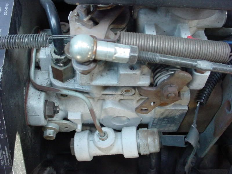

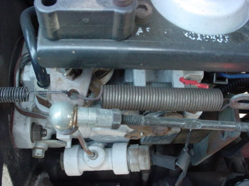

JFYI That pump looks to be a rebuild also..
