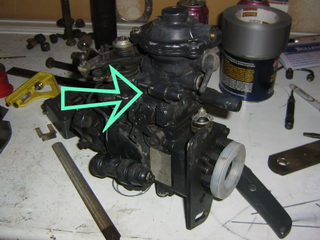

Postby dpuckett » Sun Jul 27, 2008 2:31 pm
If you are getting fuel into your AFC well (and, consequently, have fuel coming out the vent tube), you are looking at the wrong part of the pump. The o-ring that seals the AFC guide pin is behind the throttle lever (remove the throttle lever, but leave the shaft), behind the hex key plug. Remove the plug, then carefully remove the pin. You will need a small pick to R&R the o-ring. Get the o-ring back in, and then installation is reverse of removal. This one can be done with the top on the pump- BTDT.

Postby randyswelding » Sun Jul 27, 2008 6:50 pm
ok so i took that out to see what was behind it and i saw a backin plate of some sort,is that behind that or is it the copper(well its silver dont know the matterial) is that it :? ?
