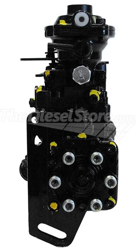

Well I remember marking which position on teh injecton pump goes to which injector but I'll be danged if I can kind teh paper. Any one help me out?

top left is cylinder 2. going clockwise from there: 6,3,5,1,4 I BELIEVE
the front three and back three are groups and alternate on the pump head, if that makes sense.

With the pump mounted on the engine, #1 is the very bottom outlet. Then going torard the engine and up and around, you have 5-3-6-2-4.
Pump turns the same direction as the engine.

It is exactly right. Truck started right up!
