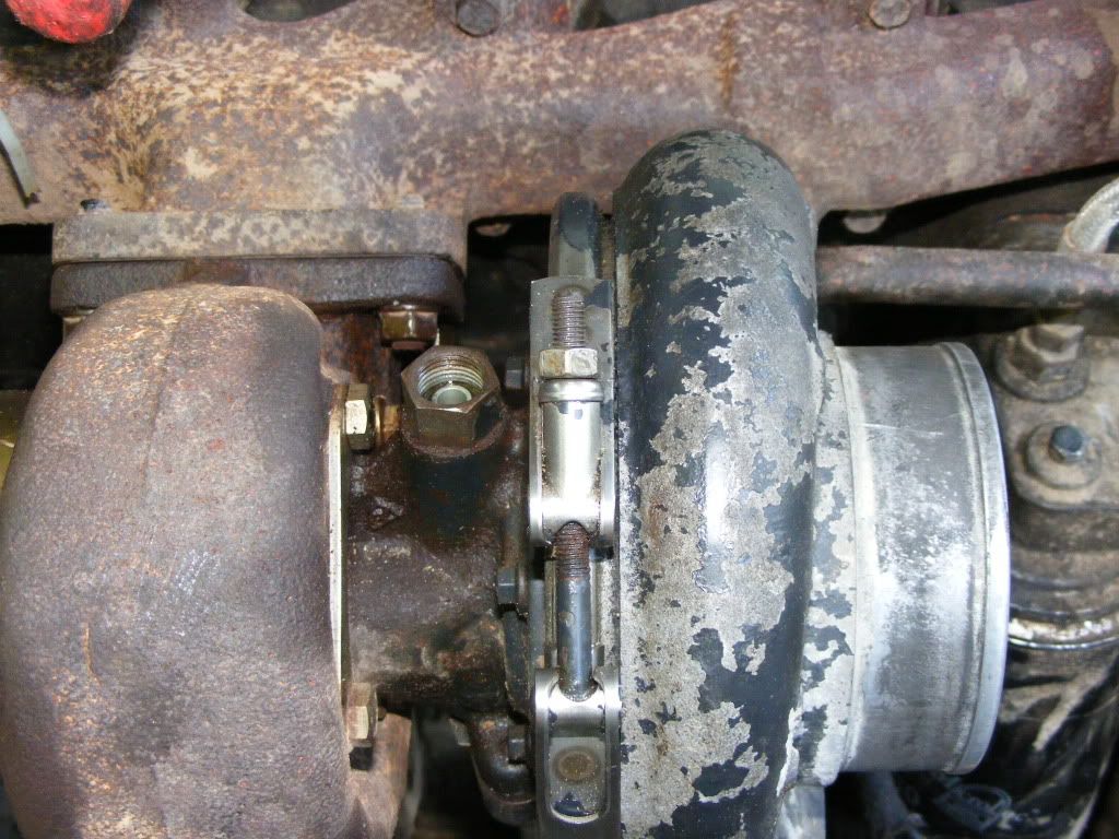

Anyone know where i can get the oil inlet adapter to make my oil line work? My old h1c's oil line went directly into the center section, the newer turbo lacks the adapter to make it an inverted flare, it just has straight threads. Any ideas?

found a pic of the thing i need....

I bought mine at a cummins dealer. I ran into the same thing on my 89 when I put the S300G on.

wouldn't happen to know a part number?

I was going to write it down but the bag it came in was ripped already right where the part number was. I think any adapter off a later model H1C or HX35 will work. If you get desperate call these guys and ask for Corey Staples. They shipped it to me so they might do it for you as well.

Well i found the part number, its 3920801 just in case anyone needs one.
