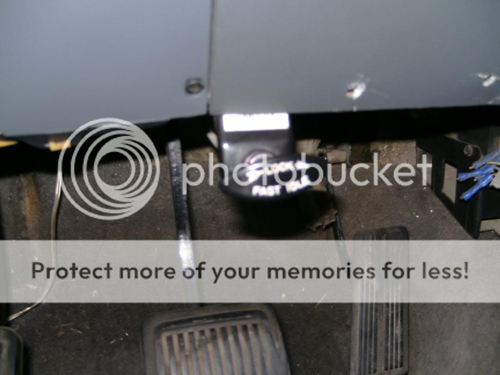

Postby pulltilbroke » Tue Oct 06, 2009 5:13 pm
Heres the pics I got sorry for the poor quality but you can see the genral idea of how the deal works

Postby Bschwarzli » Wed Oct 07, 2009 5:47 am
Pullit - Thanks! That is awesome!
Question on the gas pedal though. Is that bracket for the cable bolted, welded, or what onto the pedal?
Also, how many settings does it have? As in how many different rpm points can you set it at?
Also, does anyone know if this was a option on the trucks or standard equipment?

Postby Mark Nixon » Wed Oct 07, 2009 6:26 am
The bracket for the pull cable is made into the main pedal bracket, IIRC.
It has a limiter on it, it'll only go so far, I think around 1200 rpms, if everything is adjusted properly.
The rpm capability is "infinite" to it's upper limits, meaning it adjusts and you lock it where you want it, but only as high or low as it's design.
From what I have seen the rpm/idle lock is standard on the '89-'90 5 speed trucks.
I haven't seen it on anything else, but that's not to say someone couldn't have it dealer installed, or ordered with it.
An interesting note, I have the "window sticker" for the '90 1 ton that broke the cam, and on that sticker it actually calls out the idle lock assembly with an option code.
I didn't realize that the 1990 1-ton Cummins trucks were also nearly $20,000 new, until I saw it on an old invoice recently, either. :shock:

Postby PToombs » Wed Oct 07, 2009 5:49 pm
Robert, if you look close, you can see where the cable arm is riveted to the bracket. The cable actually pulls the arm up, pushing the throttle pedal lever up.

Postby Bschwarzli » Thu Oct 08, 2009 5:23 am
Pete - I see that. What is baffling me is why that works. Should the cable not be pulling the pedal DOWN so that the throttle cable to the injection pump is pulled toward the driver thus increasing fuel to motor?
Why would pulling the pedal UP work? People lift off the pedal when wanting to go slower.
