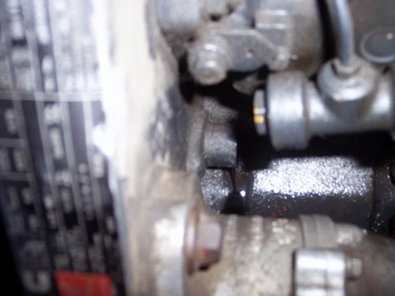

My pickup ('93 CTD) started leaking pretty bad today. I noticed it when I left it running and left it for a few minutes. I came back to notice a good steady stream of oil coming out of the front of the engine bay. Upon further inspection, I realized it's Motor oil and found where it's leaking.
It seems to be coming out of the back of the gear case, from a hole a little larger than 1/2" under the injection pump.
Pics:
It's the hole right above the round casting here. You can see the oil slick right below it.

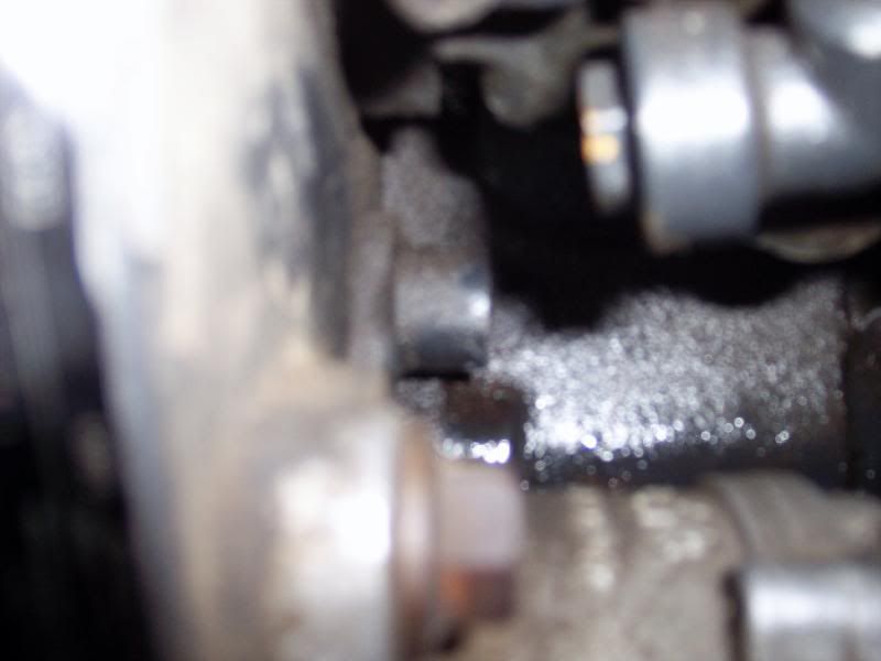

Shot of oil coming out at idle:
Anyone know what's going on?

Postby Richie O » Mon Nov 16, 2009 8:59 pm
Is that the pin that helps you find TDC when replacing the injector pump?
Postby Kebo » Mon Nov 16, 2009 9:03 pm
Richie O wrote:Is that the pin that helps you find TDC when replacing the injector pump?
:shock:
Holy crap! You're right! I used it to find TDC when I did the valve adjustment! Must've rattled right out!

Postby PToombs » Tue Nov 17, 2009 6:33 pm
There's supposed to be a star washer that locks that in there. I usually pull it out and reset it when I'm done. Any plastic plug or something that fits will work to plug it for now.
