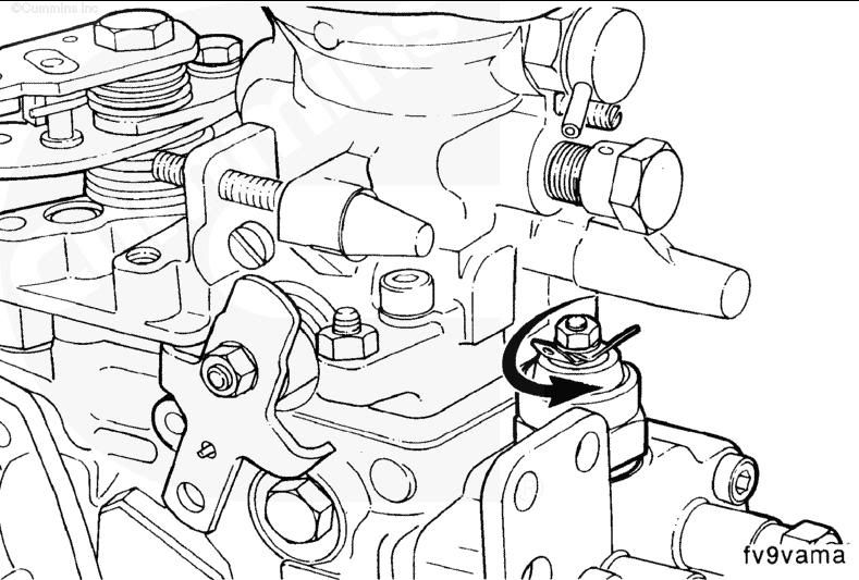

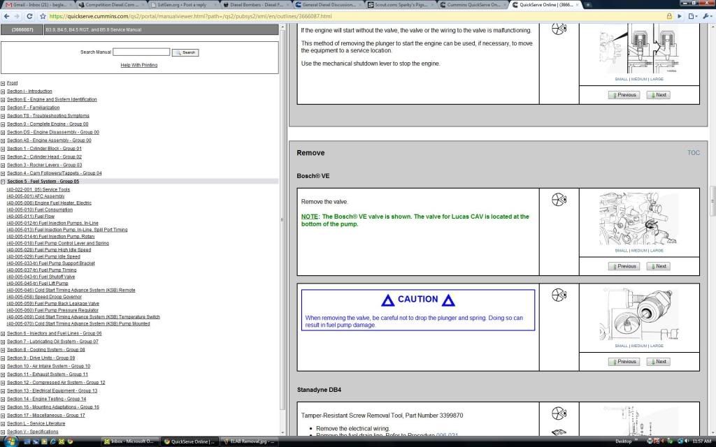

It's funny; the Cummins QuickServe procedure consists of one line: "Remove the valve."
Real freaking helpful. :lol: :lol: :lol:
Here's the picture blown up.
I don't know if the way I do it is proper or not, but first I unbolt the plate that sticks up with the two holes in it. You remove two and loosen the third of the four long Allen-headed bolts that hold the plate onto the head onto the pump, and then the plate swings down out of the way. Then I use a 24mm open-ended wrench to remove the solenoid.
