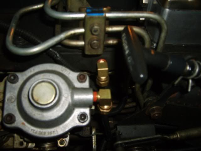

sounds like the afc line. they can break if you look at them wrong, just ask dpuckett. mine had been replaced with 1/8" line, which i later replaced with 1/4" air brake line. this is a good time to upgrade to the larger size, and its really pretty easy. i think i did it in 15 mins or so.

I used 1/4 in air hose, just get a couple 1/8 npt fittings/ You will have to drill and tap the afc cover, at least that's how I did it.

soggy wrote:I used 1/4 in air hose, just get a couple 1/8 npt fittings/ You will have to drill and tap the afc cover, at least that's how I did it.
That's how i did it... cost like 10 bucks and takes about 30 minutes tops to do. I put a shut off valve in line on mine to be able to shut off the afc control.
Also, i dont know how much timing your pump has advanced but if mine has been advanced 1/4" and i couldnt fit a 90º fitting into the head of the engine because the pump head was too close so i just swapped for a 45º fitting and all went well.

It was just the banjo bolt that broke on mine,not the hose.So I just got a new bolt..the other options look nice but then I would need to get a pipe tape..and remove the cover so I don't get metal shavings down there..
