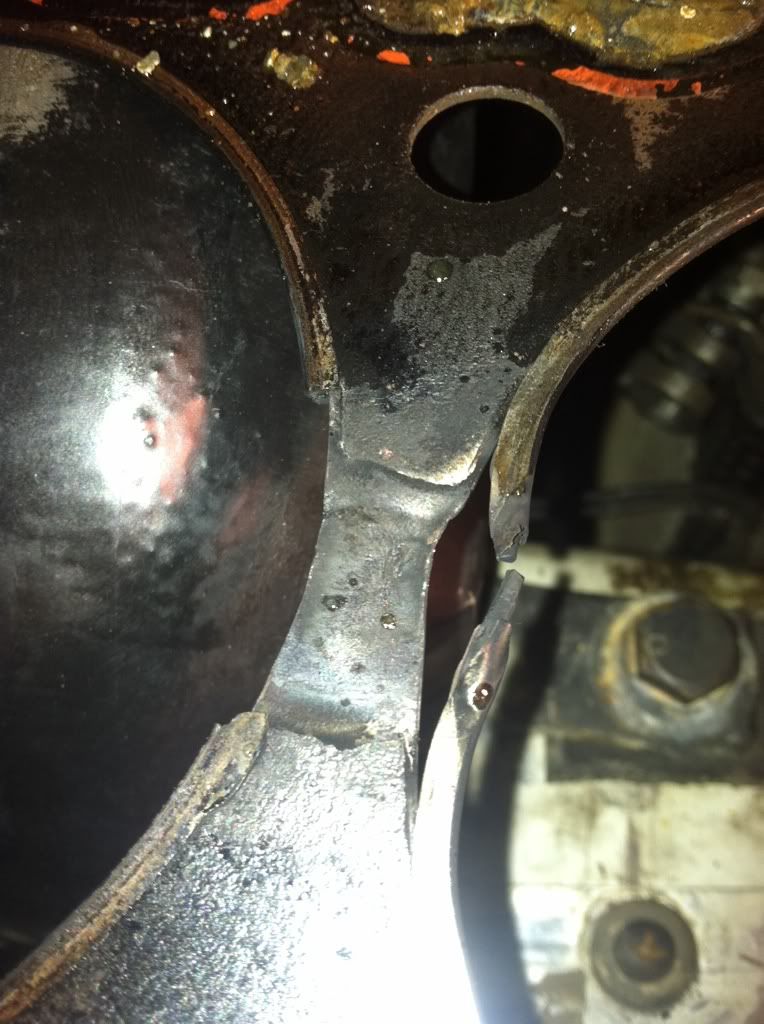

Pulled a hill today, hit 45 lbs and then She was running like crap, sounded like a valve died. Did a cylinder drop test and 2 and 3 were not very noticable, checked the compression of 2 and 3 and they both gave 100 lbs, then put compression to 2 and 3 with shop air and they were swapping spit something horrible.
Im hiping scott at mass diesel will get back to me today, im going to throw a new gasket at it with some 12mm studs, im hoping the gap between cylinders isnt flame cut from driving it home (5min)
Anyways... 330k i guess i was due :/

:shock: what's the surfaces look like?
Re: Guess Its about time...
Postby ahale2772 » Sun Dec 11, 2011 6:27 pm
They are good ellis, i'll throw a straight edge on then tomorrow to make sure but they look good, i only drove it for about 5 minutes, im sure i would have been worse any longer. Ive seen some bad "torch cut" surfacees in my day, not mine.
BTW 300,000+ miles, still see the cross hatch on the cylinders. 8)

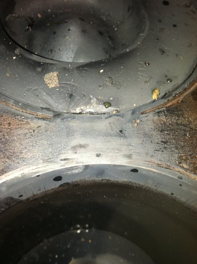

# 3 piston had a weird nick in it, hope it didnt gouge a ring, didnt have time to look it over hard.

fyi this is # 3 piston(top of pic), you can just see the nick...
