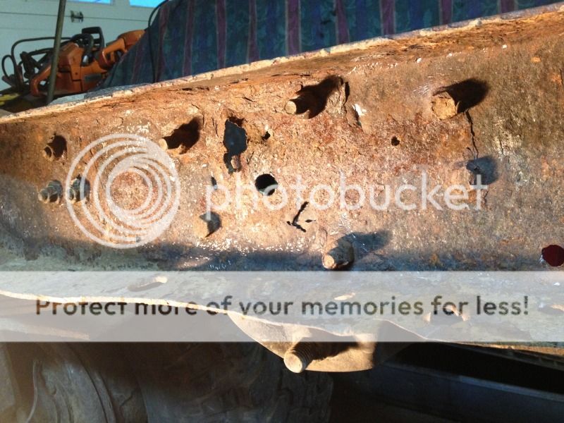

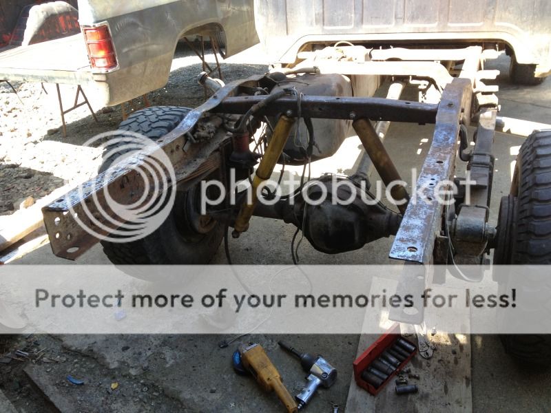

rot...

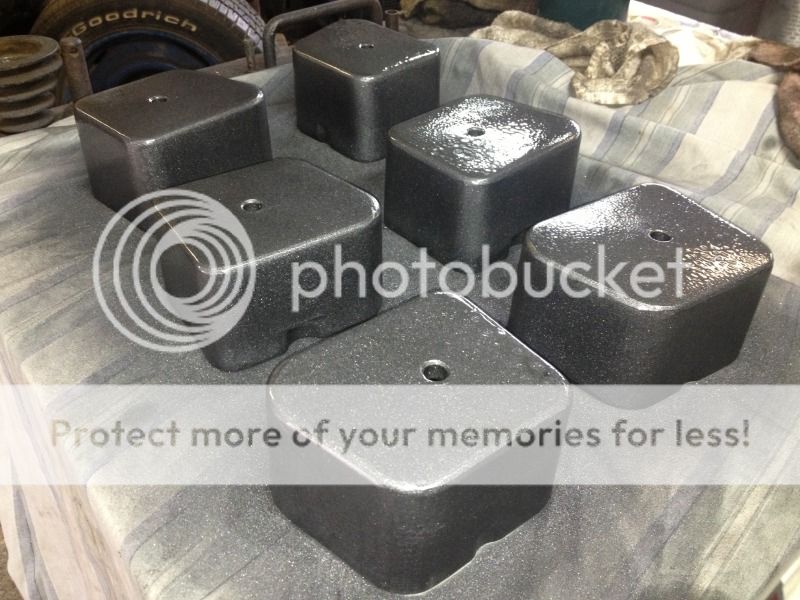

new box mounts
done

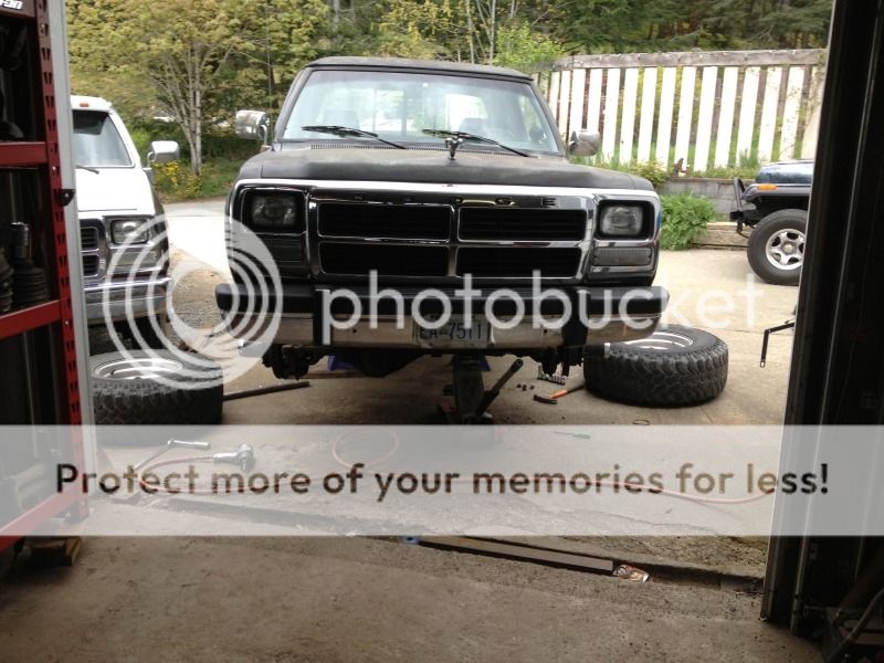

new springs a few weeks after i got itbefore
during
after

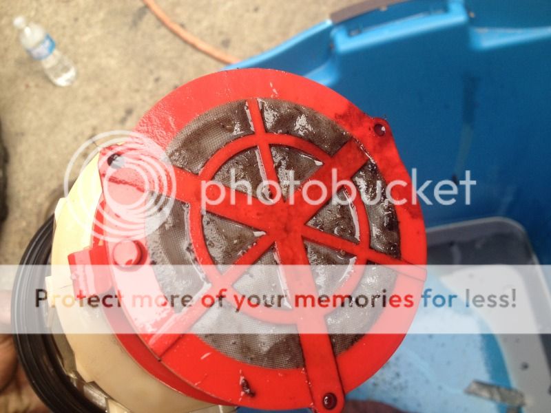

few months later... bad fuell!

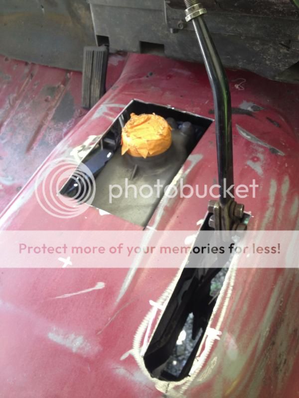

i took the fuel tank right out and cleaned it out with a cloth. sending unit
dodge helping dodge :buttkick:
after about 4 hours cleaning out all the injector lines, fuel tank and what not it flashed up!

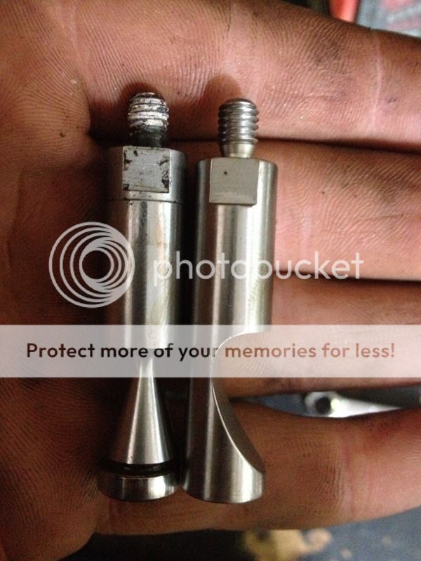

difference in fuel pins

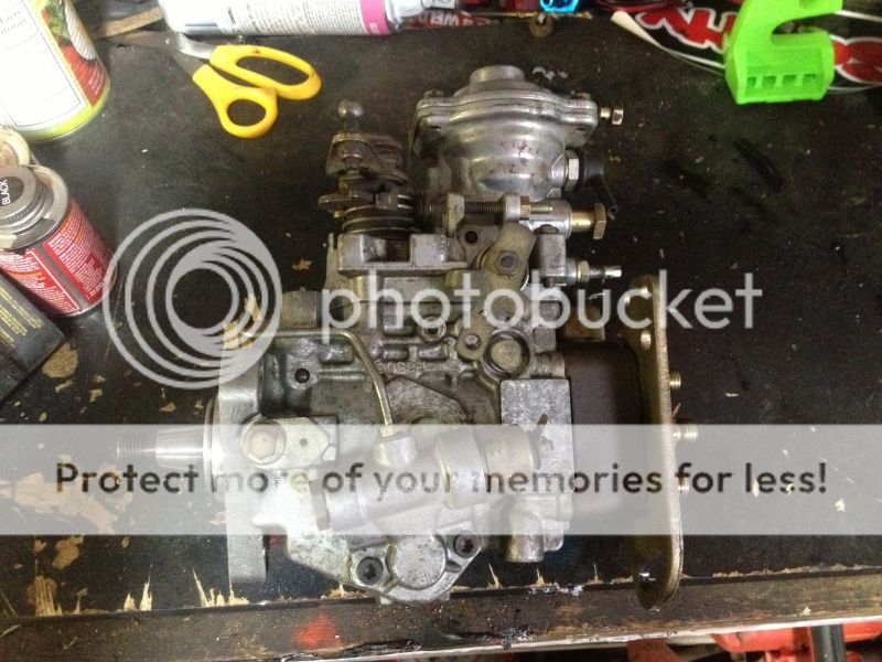

semi new pump.. equipped with 3200 gov spring and stage 2 pin.. makes 30 pounds of boost with no power screw....

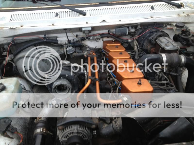

As for performance. When i bought this truck it was bone stock..
since i have bought it, I have installed.
hx35
100hp injectors
street performance injection pump
full 4 inch exhaust
bd exhaust housing
pump tuned up a bit.
Got it tuned to the point when you stomp on it, it dosent smoke out the whole town. Im looking for power not smoke.

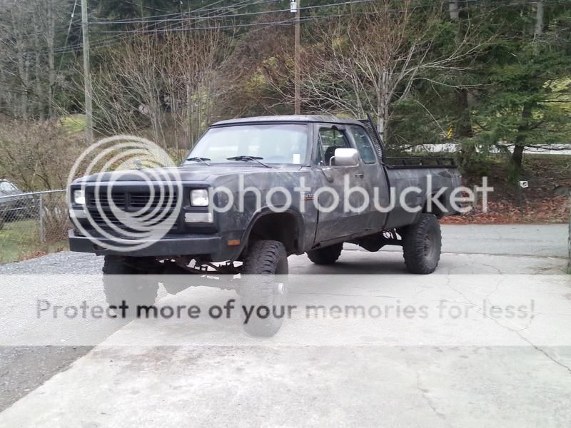

Postby firstgenny » Sun May 25, 2014 6:47 pm

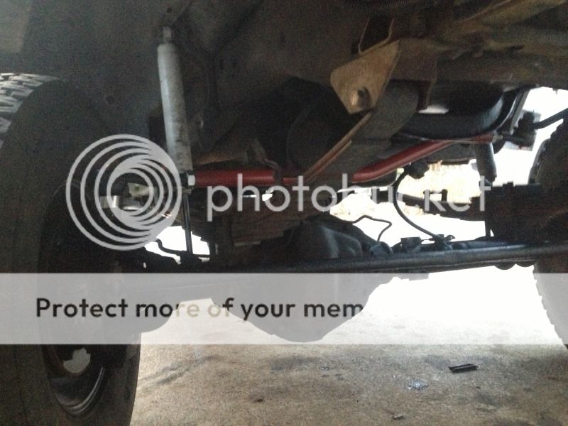

Hey guys. So when i set up the shackle flip in the back i had them a little to far forward on the frame. so with a load on the trailer the shackles flatten out witch is no good. Moved them back 1.5 inches back and it works awesome now! had the trailer with a car on it and dident even squat a inch. also have a big set of leafs in the back. Also now i have gone from a 6 inch rear block to a 2.5 inch block and thinking of getting rid of that to.
here is before...
i dont have a after pic yet.

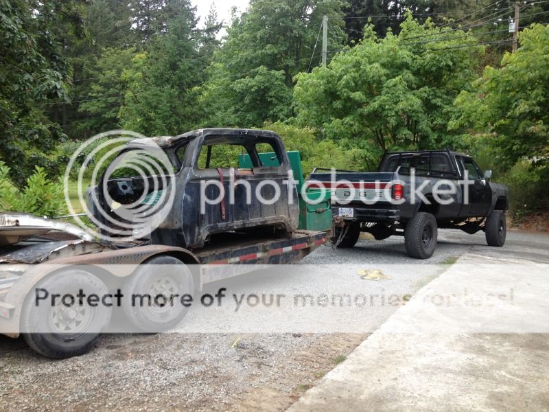

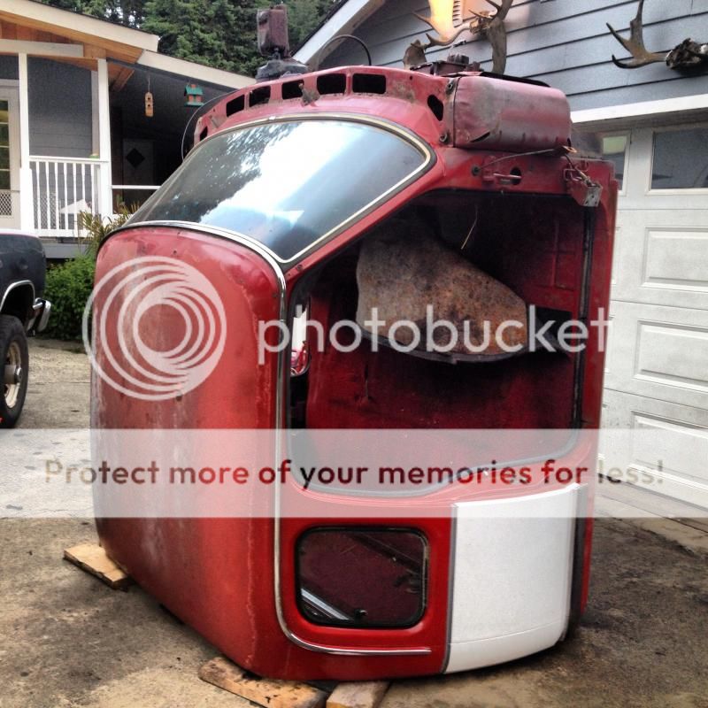

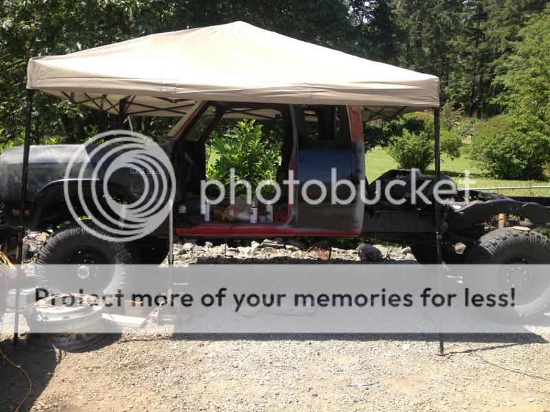

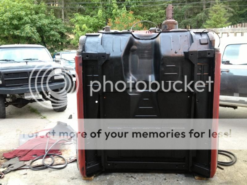

Postby firstgenny » Tue Jun 17, 2014 9:20 pm

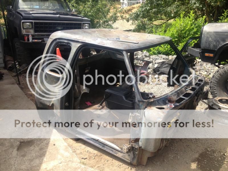

well after a full year of searching
shes clean!
me and the gf have been busting out asses trying to get it cleaned up for rust coat
and at the same time im putting this together for my sisters boy friend
well the cab comes off tomrrow

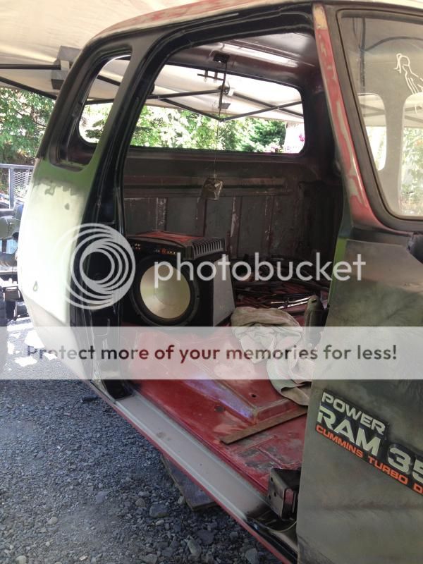

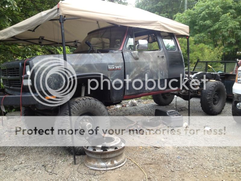

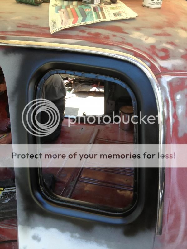

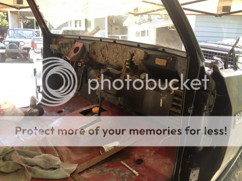

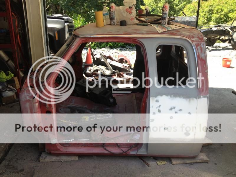

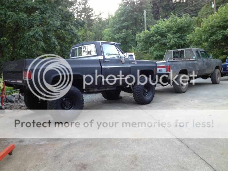

Postby firstgenny » Sun Jun 22, 2014 9:32 pm
got the cab box linerd, mounted and the start of some wiring
so fare im about a week deep in body work alone.
those were all the factory body trim holes no longer.
old one
those will get filled up
door jams done
all semi gloss black
guess thats it for right now. thanks for lookin

Postby dazedandconfused » Mon Jun 23, 2014 3:21 am
Looking good. Where did you end up finding the cab?
Re: crawler hauler
Postby firstgenny » Mon Jun 23, 2014 9:38 am
dazedandconfused wrote:Looking good. Where did you end up finding the cab?
Bout a half an hour away From where I live, nice and close!

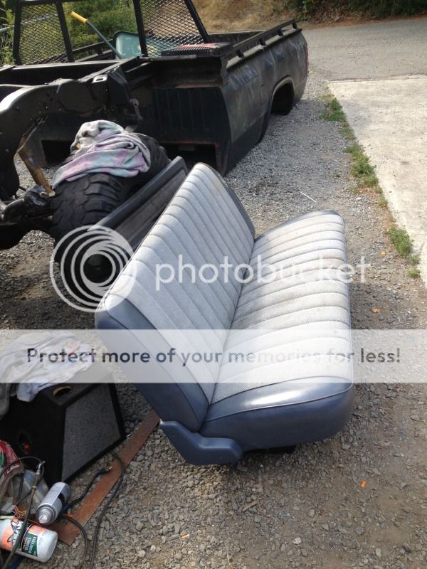

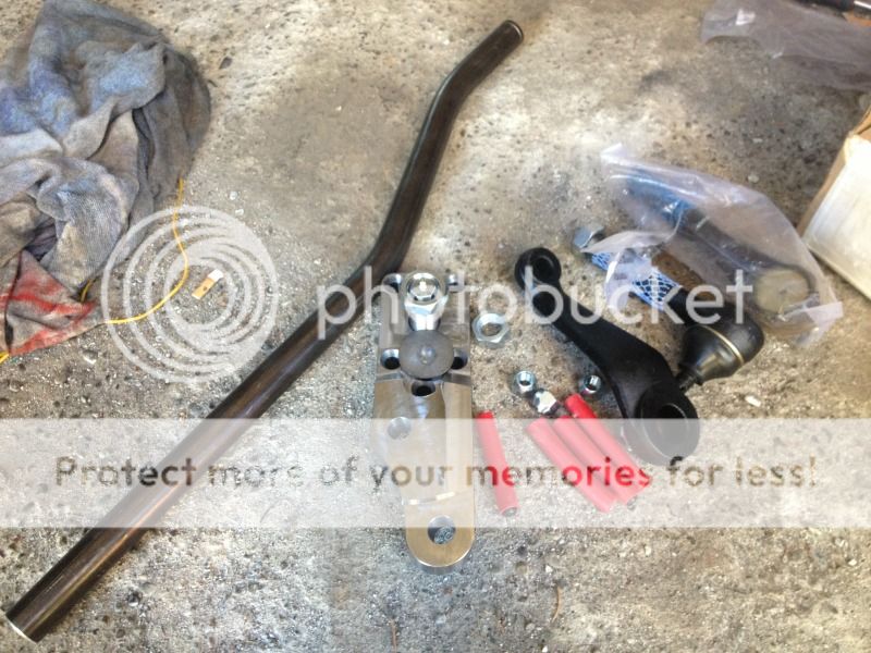

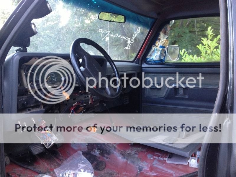

Postby firstgenny » Sun Jun 29, 2014 1:53 pm
well its comin together, doors, fenders, gauges, carpet, seat, back window, pretty much all the wiring, steering all done!
keep xj steering shaft
those pictures are a few days old!

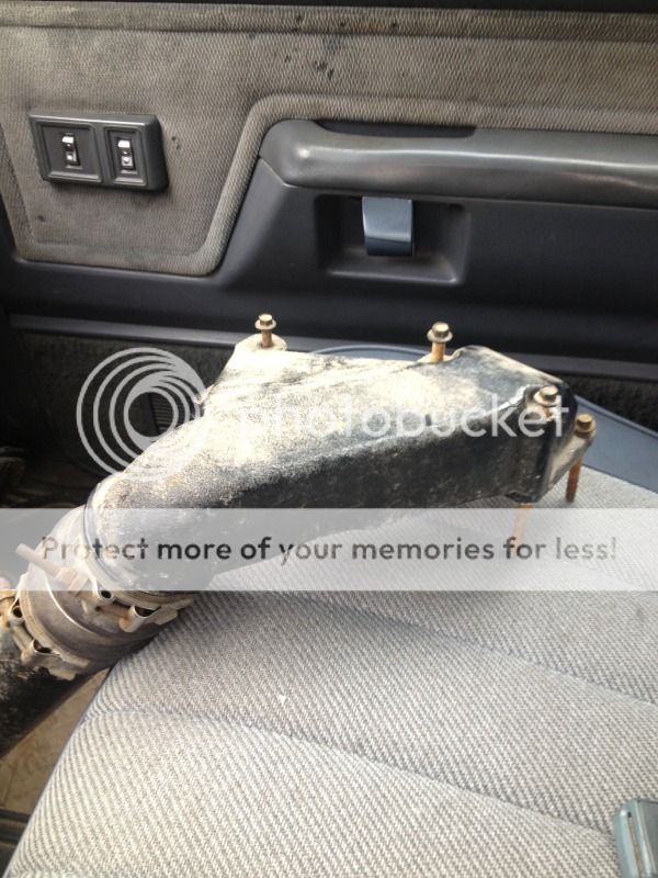

second gen intake

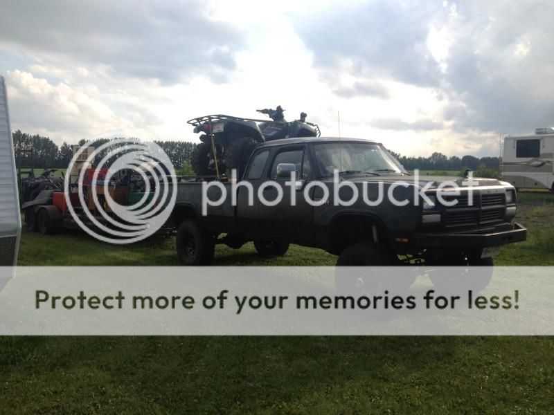

so lots of towing still

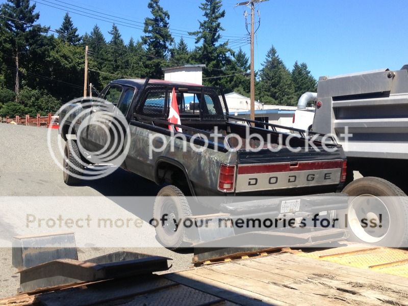

took itself to the scrap yard

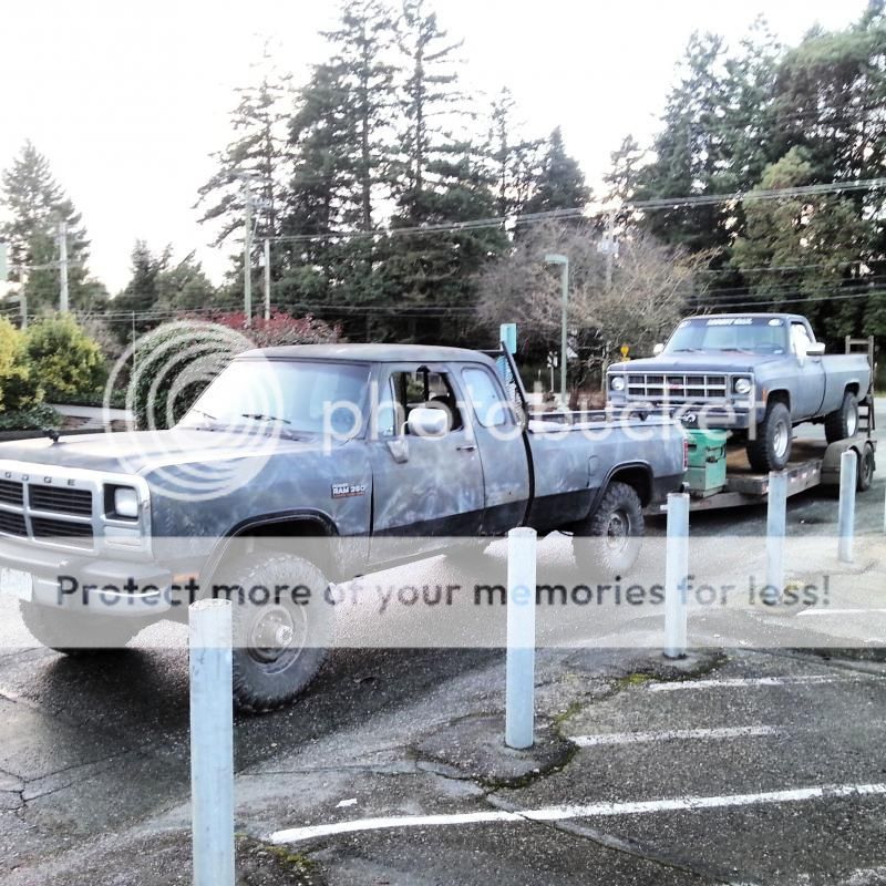

Re: crawler hauler

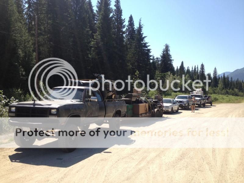

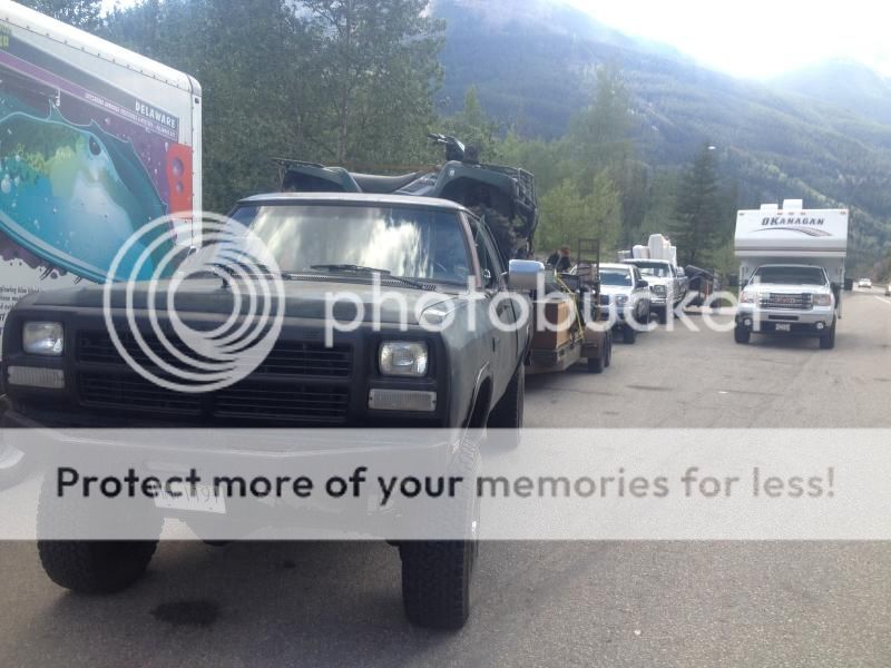

Postby firstgenny » Sun Aug 10, 2014 1:33 pm
loaded up and headed to alberta, 1300 k drive threw the rockeys.
Truck made it fine, other then as soon as we got to alberta the water pump decided to start leaking. Also as we were driving threw kamloops the hitch almost broke off :/ must have come loose and 2 of the 6 bolts broke...
dad loading the trailer up
firstgenny
