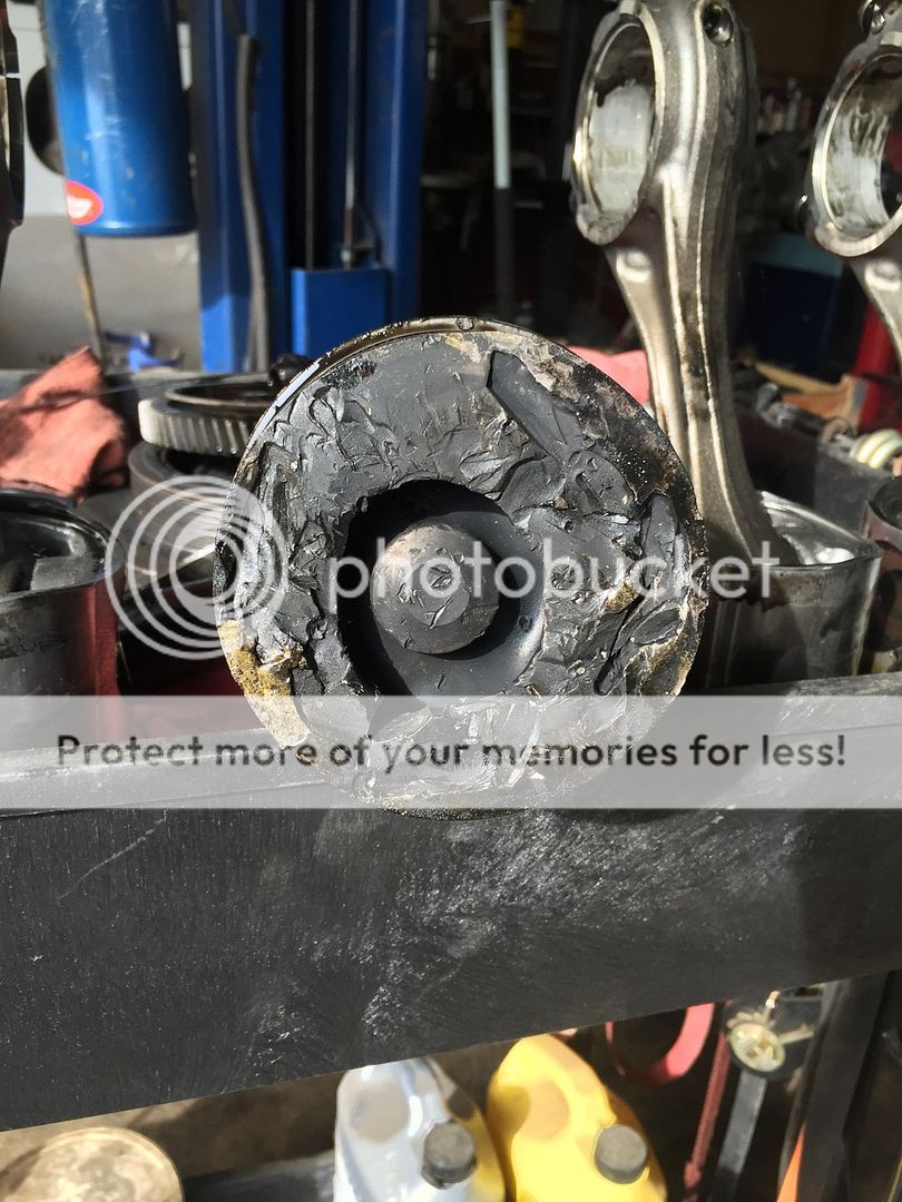

This was my morning. Industrial p pump 12 valve in brush cutter. The piston is from #5. 2 of the other pistons had scuffing on the skirts, and 2 of the cylinders had marks from having water in them, and being left to sit. All the crank journals looked good though.

Interesting note this is an encore block, and has cracked cap rods. It's also interesting to see a p pump that isn't a p7100. The entire pump case is different, and the governor assembly is more like an m pump

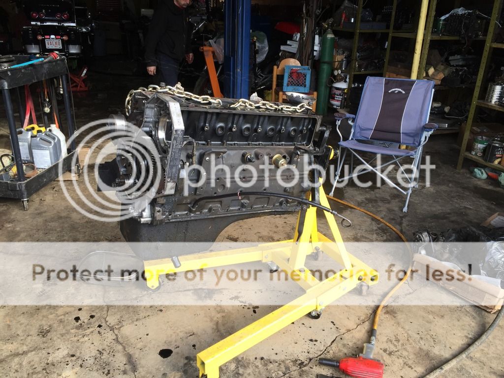

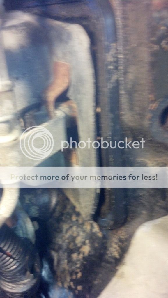

So the 24V donor had oil all over the drivers side. After steam cleaning it looks like there is a issue with the tappet cover.
Re: 2015 BS and Chat Thread!
Postby DMan1198 » Sun Mar 15, 2015 11:59 am
Hmm. That doesn't look good.
Postby fatty » Sun Mar 15, 2015 1:46 pm
Is that the cover separating or is that the insulation? Can't really tell, pic is a little blurry.
Posts: 803
Postby dazedandconfused » Sun Mar 15, 2015 1:51 pm
I can't tell but its leaking from the cover. It was a oily mess from the bottom of it down. I guess I'll be pulling it all apart since its easy to get to right now.
Postby PToombs » Sun Mar 15, 2015 2:21 pm
Looks like the insulation is coming off. The gasket is probably rock hard and not sealing, it's what they do.
Postby dazedandconfused » Sun Mar 15, 2015 2:38 pm
Yeah the gasket I see is harder then hell. I'll replace it before it goes in the Ford. That was the only real place I saw it leaking.
