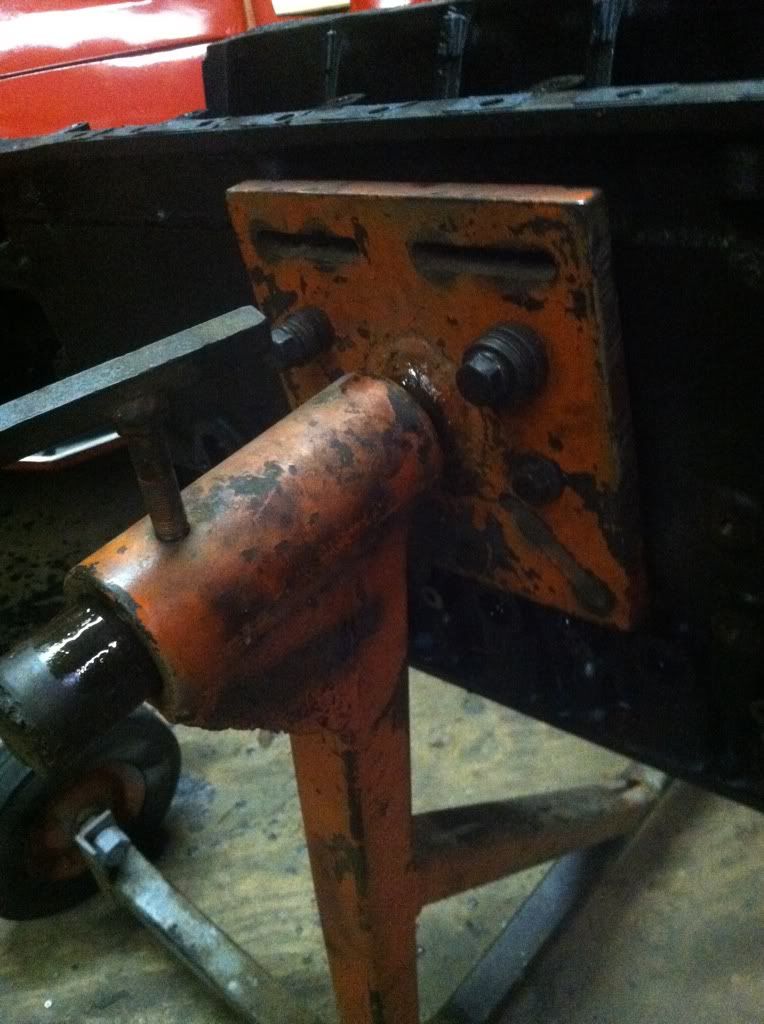

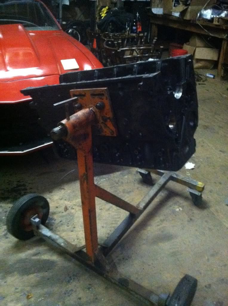

I ended up just drilling my stand's plate out to the holes on the block, once i get her set up i''ll snap a piccker, may still build a support for the front, if its super heavy.

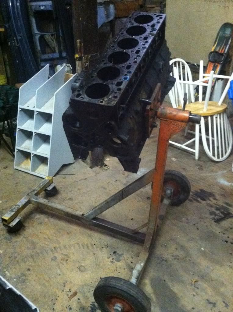

got her mounted on the motor mount, surprisingly sturdy, im not worried about it at all. I need to build a pin system to hold the engine in certain positions. other than that im real happy with this stand. found it in the barn, looks like some leftover from my Dad when he used to occupy the barn, before mom-dad divorce BS.
the engine is balaned as pictured here, not perfectly level, nut the COG is definently not in the center of the block.
