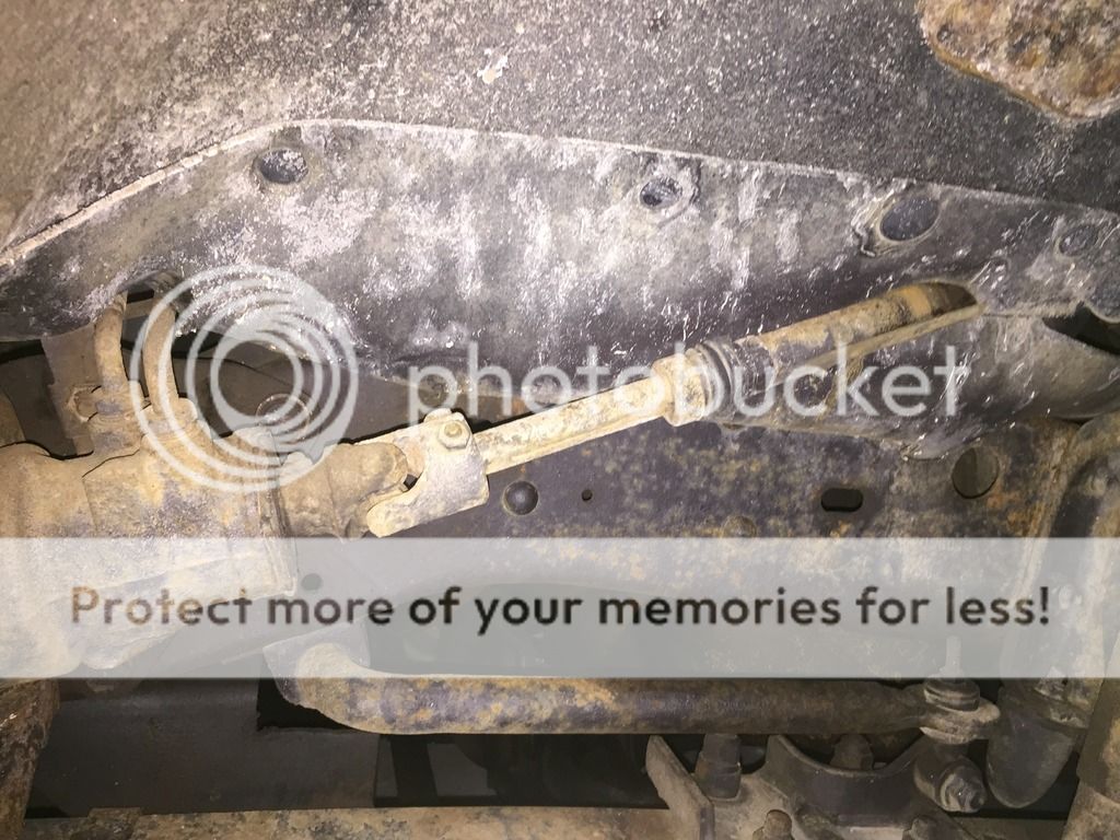

Postby DMan1198 » Fri Jan 13, 2017 10:17 pm
Here's what my 8 year old borgeson steering shaft looks like if you want a reference for what you want to make.
