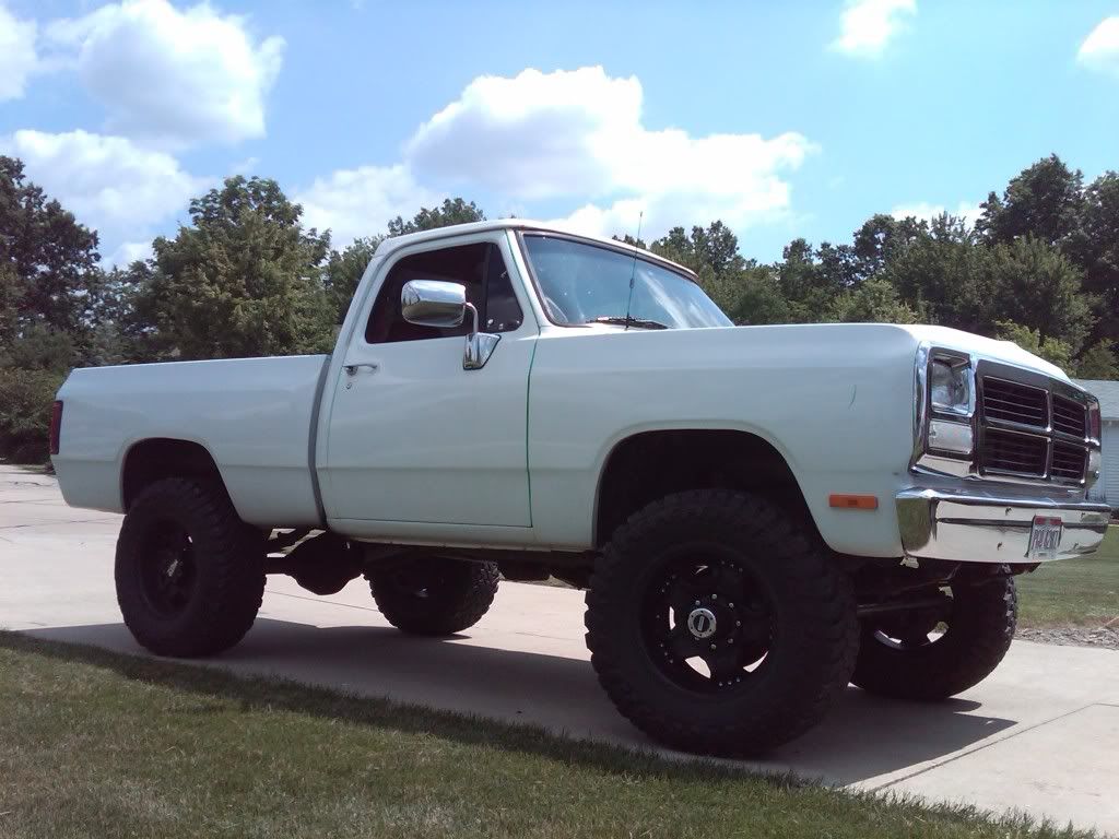

heres a pic of a finished one
Postby mikcon » Tue Jul 07, 2009 9:01 pm
If I can figure it out here is my reg cab shorty.
Image[/img]
