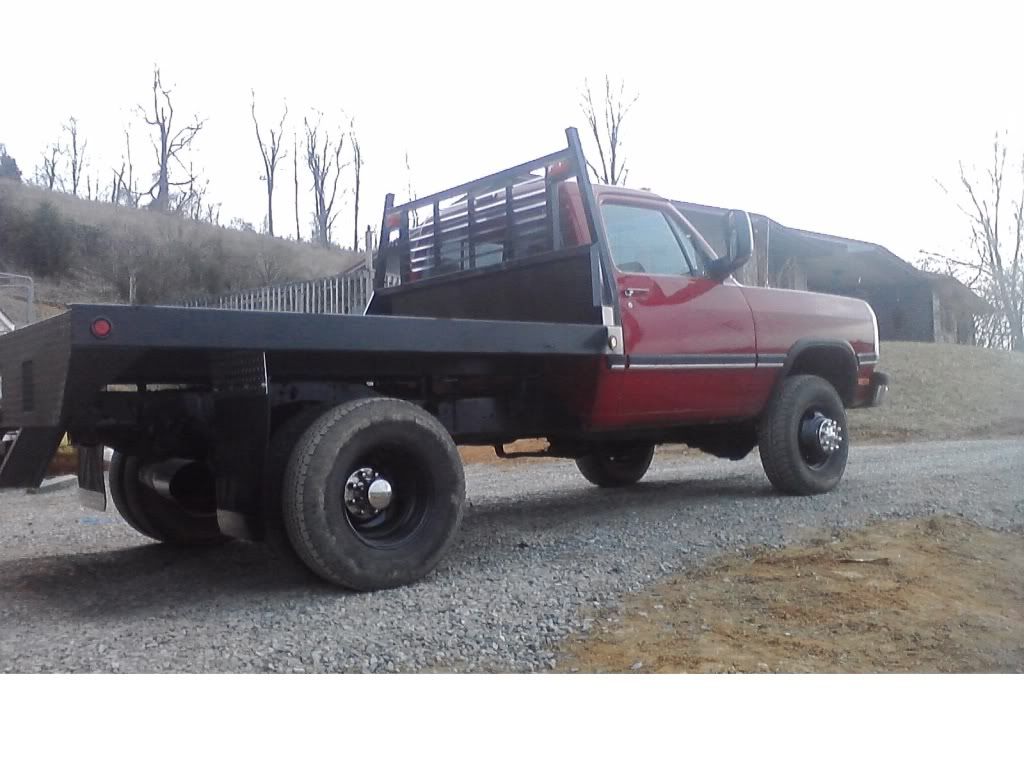

Postby ahale2772 » Thu Mar 24, 2011 12:06 pm
that one showed up ok, love the black dually's with the chrome center, thats the only way to do it

Postby CaseyF » Sun Apr 03, 2011 7:20 pm
Sorry its been a while since Ive got on here. I got center caps and simulators on ebay a while back, and I wanted something different so I painted the wheels black. The center caps are like stock ones but my front ones arent cut out for 4x4.
1992 W350 flat bed. GlowShift Gauges, 3.54 gear, Full Power Screw bottomed, DennyT Pump Top Delete, 366 GSK, Custom CAI, Pro Comp fuel pump, DE 4'' Exhaust, 14cm Exhaust Housing, Getrag.
