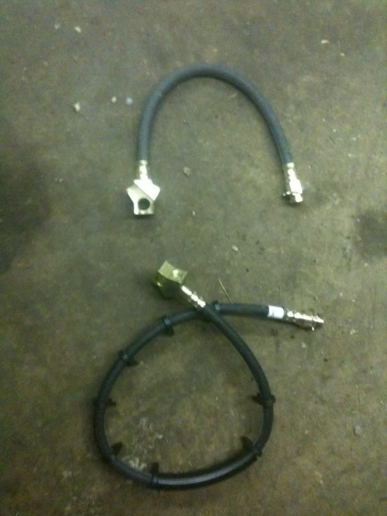

Alex, have you checked the hoses? When they get old they swell, or the clamps rust and squeeze them shut.
Re: Brake pedal stays down after pressing
Postby ahale2772 » Fri Nov 04, 2011 4:11 am
yeah Pete, new hoses about 3 months back, except the one that goes frame-axle.... :roll: .... seems like Napa and the rest think my truck does not have it.
I may try and make it out of braided nylon/stainless. Dad just made up new hoses for the Mog in stainless braid, its artwork. i think he paid big $ for the tooling though
Postby PToombs » Sun Nov 06, 2011 5:45 pm
Tell them it's for the rear. Better look and make sure it's close to the same though. ;)
Postby ahale2772 » Mon Nov 07, 2011 5:49 am
the rear is about 1/2 a foot longer, there is one from napa that is similar for the front, but the t block that bolts to the axle is way taller, hence the breather bolt wont work, and one needs to stick it in the Mill and mill it down.

I know at one time they had them. I put one on my 89 a few years back.

Postby Tacoclaw » Wed Dec 14, 2011 8:29 pm
ahale2772 wrote:lol. I'm just whining because the parts guys allways tell me "nope you have a left outer and right outer.... and thats it" :mad:
FWIW, I just picked up all 3 from Carquest. My front brakes are starting to work, I'm pretty excited! Never had any before. :grin:

Postby ahale2772 » Thu Dec 15, 2011 4:56 am
any part number for the center one??
Postby Tacoclaw » Thu Dec 15, 2011 4:15 pm
I may have lied to you about that, Alex. I ended up with one for the rear. :oops:
They do have a listing for a 3rd front brake line, but it's supposedly only for the "lighter" 3500lb axle. As far as I know, all the 4x4s are the 4500lb axle. I may just order it anyways and see what it is, since it came up under W250 on their computer.
Postby Tacoclaw » Sat Dec 17, 2011 4:28 pm
BENDIX Part # 77922
Rockauto has it listed under this #, Alex. It specifically says front axle to frame. 8)
Postby Tacoclaw » Wed Dec 21, 2011 3:49 pm
Bumping with the triple post for photographic confirmation:
