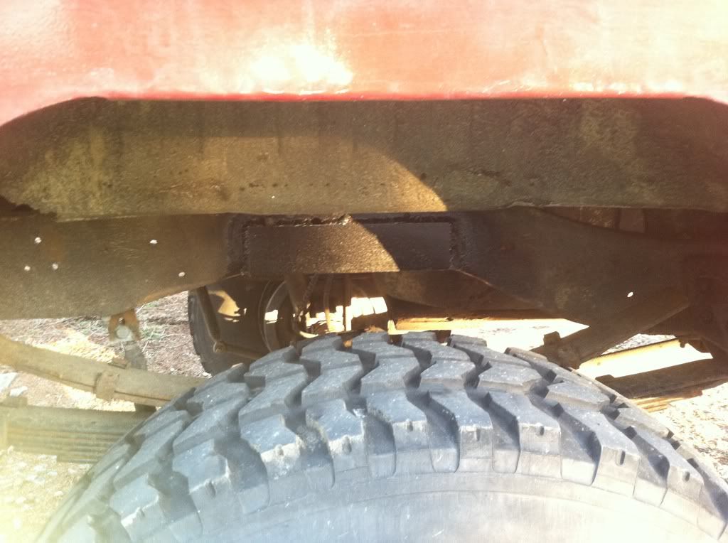

Just as an FYI... for people who live in any area's with lots of rust...
on the rear "axle hump" of the frame there is a bumpstop, with a steel plate and (I think) one 1/2inch bolt that holds it on.
Ive seen 3 different trucks where they hold moisture and rot, when they do they will bore a hole right throught the frame...so take a look at your truck!
I didnt get a picture of the crack on my frame... but the hole had spread to a crack about 1 inch long going vertically up the frame... :shock:
mine is the 3rd truck I have fixed now, one was a very nice "rust free" 93, and it was a big gaping rust hole under the bumpstop
i put a piece of angle iron in, welded it up, called it good. i know its not good to weld perpendicular o the length of the frame...but it had to be done

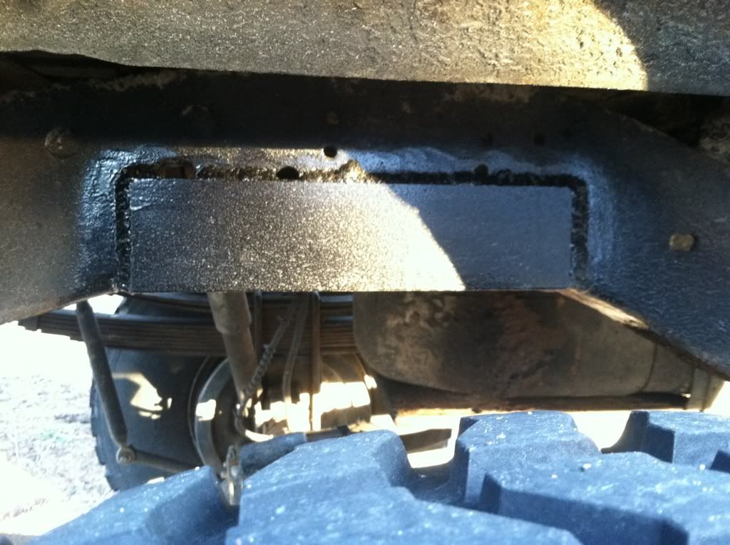

Postby slow_90firebird » Tue Feb 07, 2012 12:11 pm
mine rotted in the same spot. I just cut the bottom of the c-chanel out about 4" wide and up to the inside edge, then folded it back a little and cut along the crease. Patched in a new piece of steel and welded down where the crease used to be, and 2 welds across.
