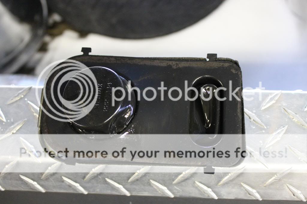

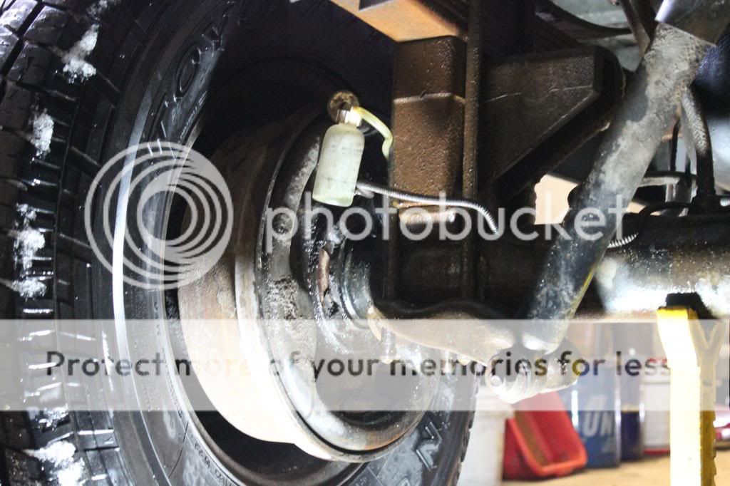

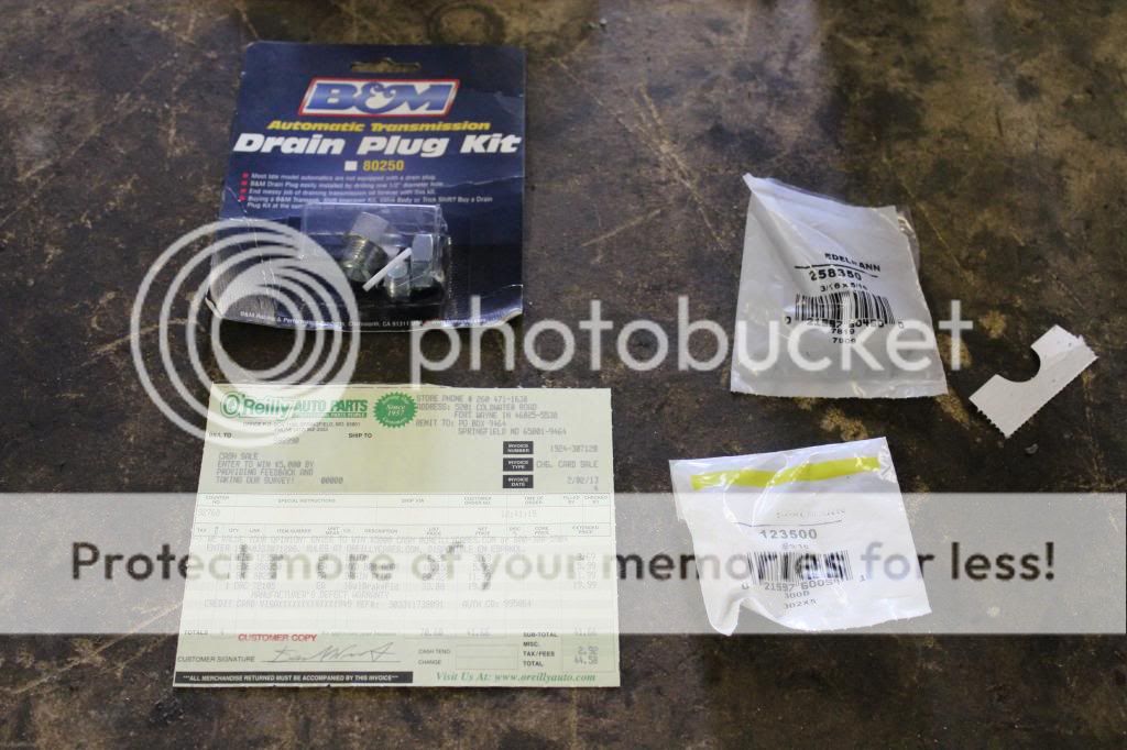

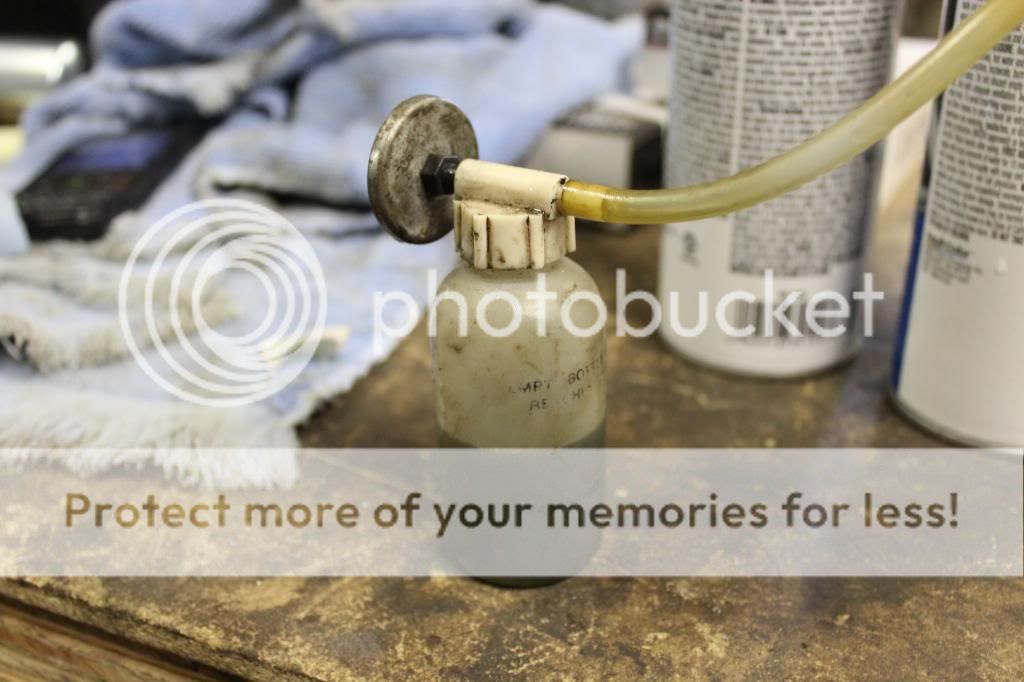

Here is my RWAL delete job.
Went of O'Reilly's for the parts since my local Napa didn't carry them
Prices didn't change from what I read on here.

Master cylinder lid gasket was a bit dirty, cleaned it up a bit.
Bleeding my brakes. The driver's side drum bleeder was rusted shut, i had to pull it out and clean it up.
You can see up top is my reroute for the brake line.
Dirty brake fluid, I tried to flush as much as possible!
