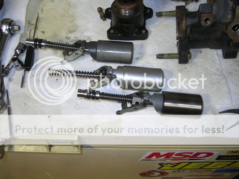

Seems there are two different types of pistons, one steel, and one aluminum. My 2000 Cummins HB had an aluminum piston, and the 1995 Astro Van HB unit had a steel piston. So I went back to the wrecker to find another aluminum unit, and pulled one from a mid 90's Chevy 3500 truck...and it had an aluminum piston as well.
Top...Chevy, Middle...Dodge, Bottom...Astro Van.
Another thing about pistons, and perhaps this is specific to aluminum vs steel, or maybe not? The depth within the piston itself where the pushrod to the MC rides, is shorter on the Astro Van steel piston compared with both the aluminum pistons. So you can not mix and match pistons and push rods at a whim like I thought I could.

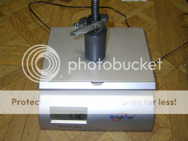

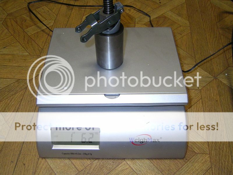

Here is the weight differences in the pistons....
Astro Van (Steel)
Dodge (Aluminum)
Chevy (Aluminum)
