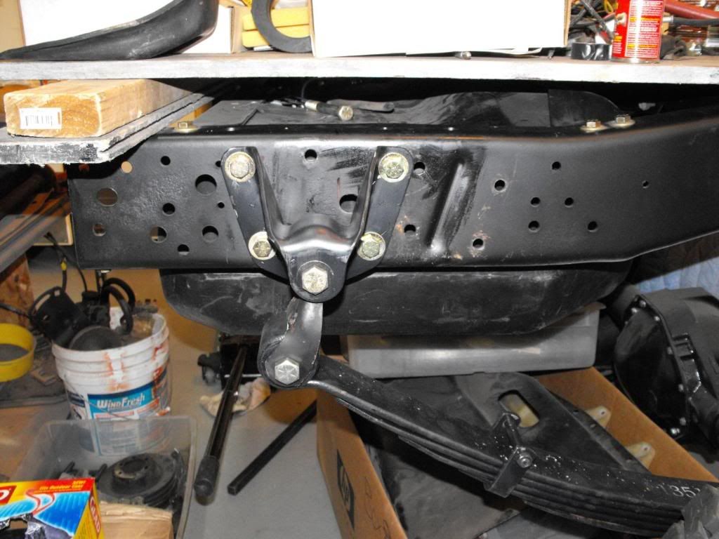

Postby Mad Max » Tue Dec 02, 2008 10:22 am
sure ;) - looks like this:

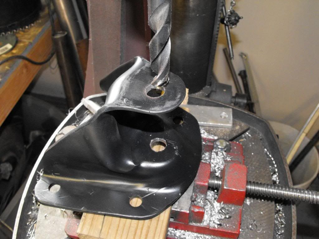

Essentially take a rear leaf front hanger and bolt it up in back, and the shackle hangs down verse up. Fantastic and cheap way to a quick 4" lift. But, while yer at it swap in a set of 56" chevy springs and gain a lot better ride quality and some nice lift. There is a little bit of 'voodoo' (fabrication) required but it's super simple.
First, depends on which shackles you're be using. If reusing the stock DOdge rear shackle you'll need everything out back to accept 5/8" bolts. The hanger is factory drilled for a 9/16" bolt, so you'll need to hog out the hole -
The stock DOdge springs have the correct bushing sleeve size, but if you go Chevy you have to hog out the bushing sleeve too -
There's a LOT of meat in the sleeve making for hoging it out to 5/8" a breeze. Just drill straight ;)
Then, figure how much suspension flex you want, bolt the shackle and hanger up snug but loose, and then locate where on the frame you want the hanger to be so you have both good compression and, most importantly, extension. I typically bolt the hanger to the frame so the shackle is right about 30* with full weight on the frame.
I'll post a few more pics in a bit.
