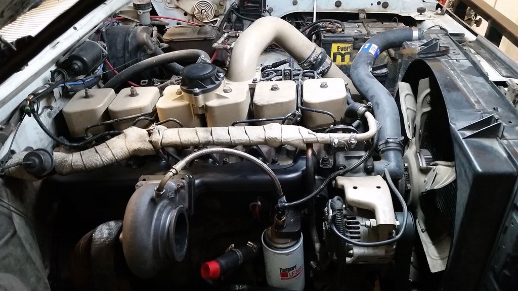

Good afternoon everyone. Started tearing things down last night to get my project started to hopefully be able to hit the strip a few times this season. Flipped my manifold last night and bolted on the .7 housing to do some measuring. My s475 should be here sometime this week or early next week as well as my flanges from stainless diesel.

I've got around 3 weeks to get it done, everyone is on vacation so I have some room in the shop haha. I won't be building a downpipe yet though just going to a hood stack so I can get to testing and tuning quicker.

What turbine side did you get on your 475?
Re: My Compound Build Thread
Postby t_ruffcorn » Sun Feb 14, 2016 9:28 pm
If I didnt push myself to get it done itd end up taking forever. that's the same reason for my hood stack haha. It's got a 1.32 a/r on it now figure I'll try that out, maybe drop a billet compressor wheel in it if need be. Ideally I'd like to get ahold of a 1.1 a/r but they are like 600 bucks....

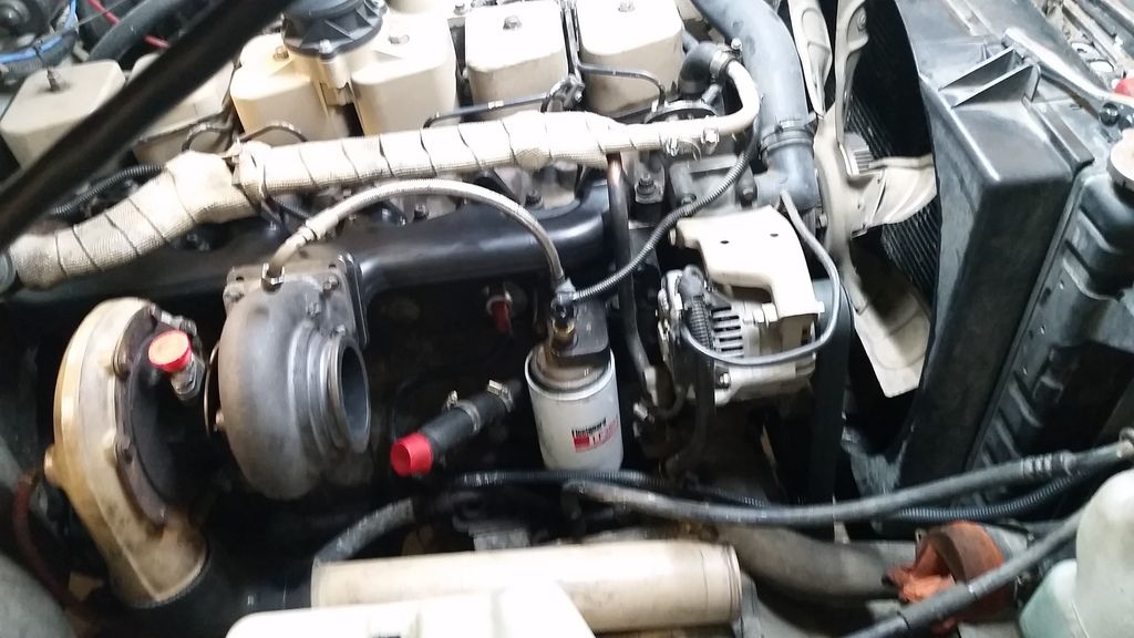

Tonights progress consisted of clocking the secondary, and final measurements. Ordered probably 90% of what ill need to get her running again. Just odds and ends left now. Took me a little white to click checkout on my orders tonight... put the hurt on my checkbook. But it'll be worth it hopefully!
