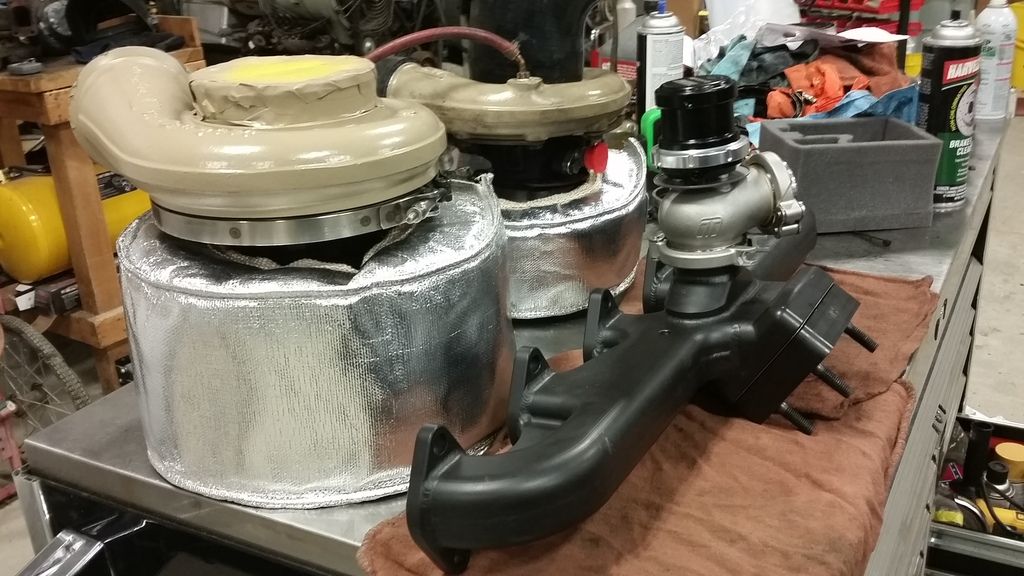

Postby t_ruffcorn » Mon Feb 22, 2016 10:24 pm
My external gate came in today, unfortunately had to pull the manifold back off and do some tweaking to the divider on my wastegate port. Had a photo op with the thermal blankets too. If your looking for a blanket, Thermal Zero is the way to go, 3 different colors, made in the usa, and way cheaper than any others i've seen.

Re: My Compound Build Thread
Postby PToombs » Tue Feb 23, 2016 4:29 pm
That's a nice looking set up. How much did the blankets run ya?
Postby t_ruffcorn » Wed Feb 24, 2016 6:06 pm
Thanks man. This has been a long time in the works. 99 for the t6 and 79 for the t3, they are made in the USA By thermal zero. They fit awesome. Bought them off amazon.

Postby DMan1198 » Fri Feb 26, 2016 9:12 pm
Do you know if they're available in black?
Postby t_ruffcorn » Sat Feb 27, 2016 11:27 am
Yes they are in black too

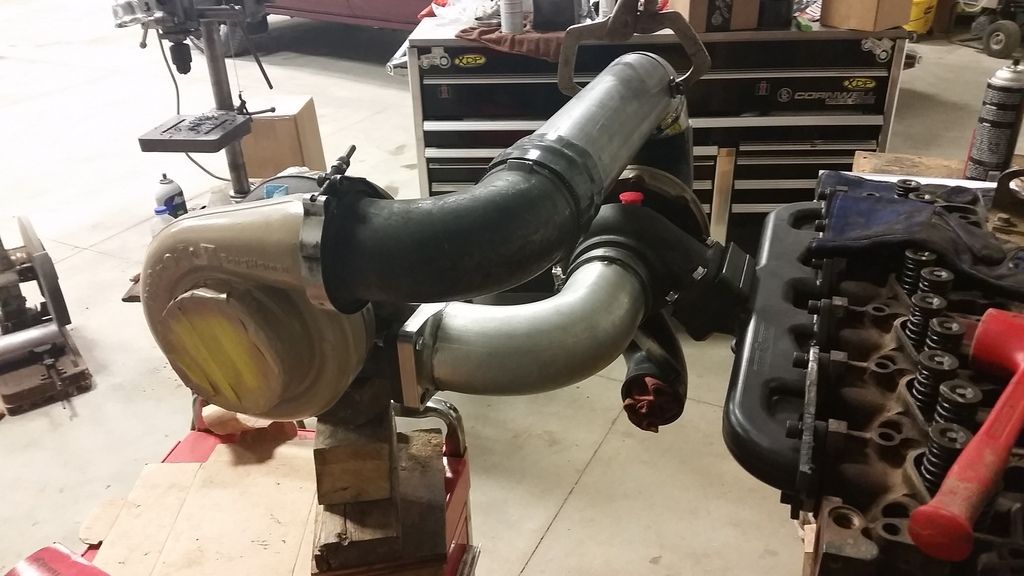

Postby t_ruffcorn » Wed Mar 02, 2016 8:47 pm
Got in the t6 flange, and tacked things together for the 1st mock up. I've got to tighten up my hot pipe, the way it sits now my s475 is hanging out way too far. Also not going to be able to use the vband elbow that I have. Going to need to fab up an elbow. Overall some progress was made tonight just not satisfied with the positioning of things. Image

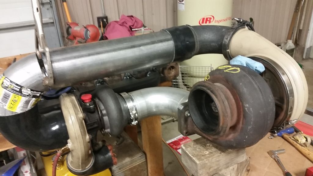

Postby t_ruffcorn » Wed Mar 02, 2016 8:49 pm
Heres the front view

Postby DMan1198 » Thu Mar 03, 2016 10:05 pm
Umm just putting this out there, but are you aware you don't need that secondary spacer when running the secondary in that orientation? It's only actually needed if running the secondary facing forward with the manifold up like I did with my compounds
I don't know if these numbers will actually help, but I got them off an he551 to 4" 90 (turned out to be the same size flange as standard cover s400's) it's a much tighter radius than what you have there

Postby t_ruffcorn » Sat Mar 05, 2016 10:17 pm
Yeah its a t4-t3 adapter. I plan on going to a 66/80 setup and a p pump eventually so I went with a t4 manifold. Thanks for the numbers. I'll have to take a look at them

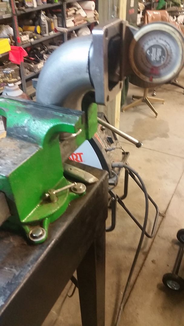

Postby t_ruffcorn » Thu Apr 21, 2016 9:26 pm
UPPPPDAAATEEE. Finally got all of our corn in the ground and the spraying done. Its been raining a lot here in the last few days so I took some time and really hammered things out.
Got the hotpipe tightened up a bunch more
