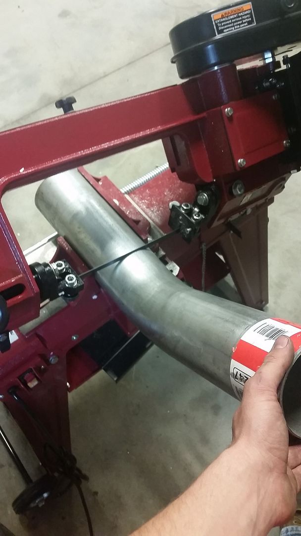

Got myself a band saw. Had to try it out.

Postby t_ruffcorn » Thu Apr 21, 2016 9:38 pm
Works pretty good actually, got the charge pipe welded up here, gotta make a few adjustments to it

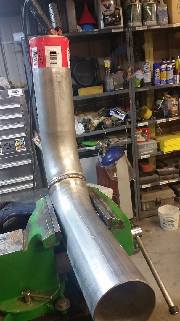

Re: My Compound Build Thread
Postby t_ruffcorn » Thu Apr 21, 2016 10:12 pm
Got the charge pipe and hot pipe done today as well, welded in a 1/8 NPT bung for secondary boost pressure. No picture of the finished charge pipe though, I got into a hurry to get it off and headed to powercoating in the morning. Did the first fitting on the hood stack elbow as well. Kind of nice to see it coming together finally
