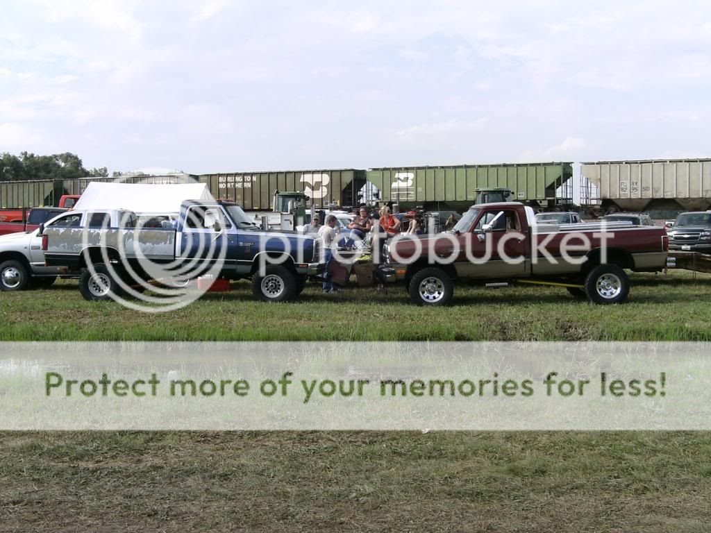

Postby pulltilbroke » Fri Apr 16, 2010 8:07 pm
Heres some of mine.

Looks good. How are your VE's against the ppumped or cr trucks? What classes do you guys pull in? I'm looking at pulling in our local 2.5 class.

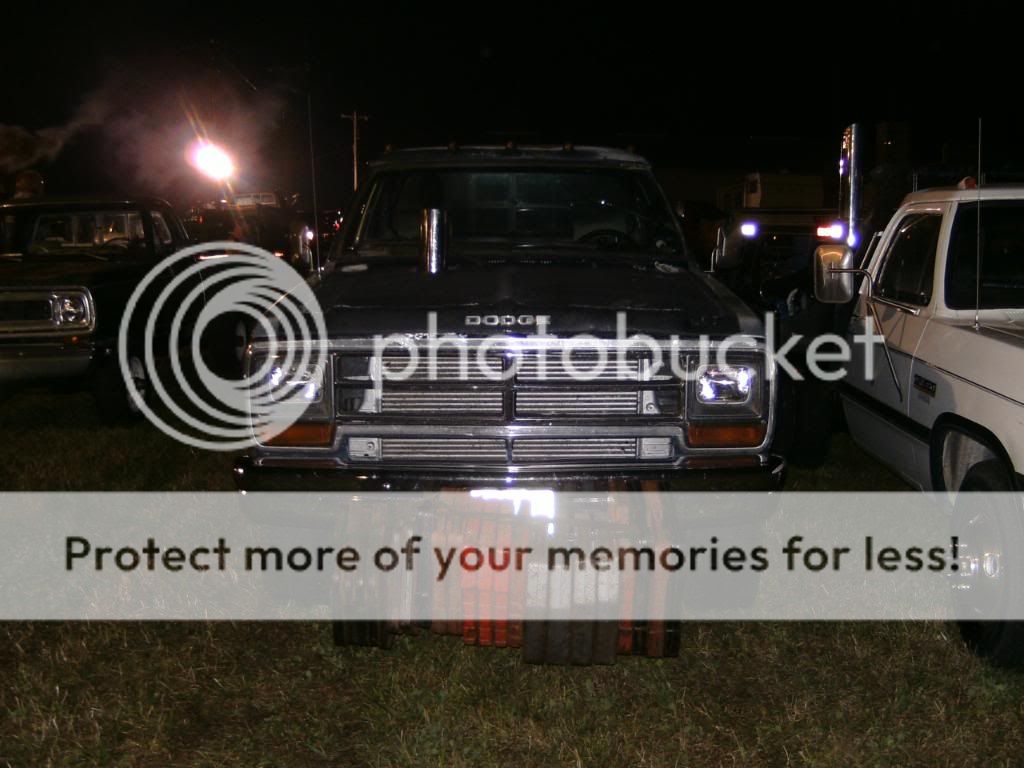

What are your weight rules? How much are you hanging off the front? Throwing any in the bed? Thanks.

In the 7500lb class I hang 1500 and in the 8500 I hang 2000 some of it goes in the bed sometimes.

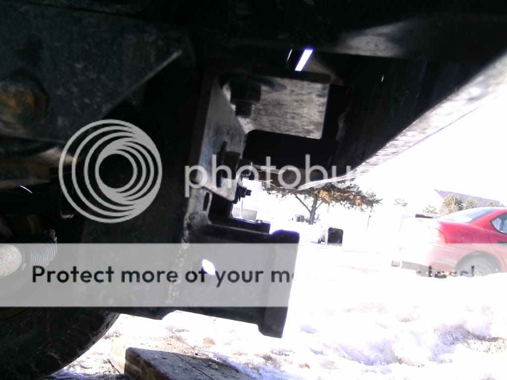

i know ive read this before but i cannot find the thread anymore but what is the name of this rear end? its just awesome.

HO72 if im correct

Yep GM Corporate HO 72

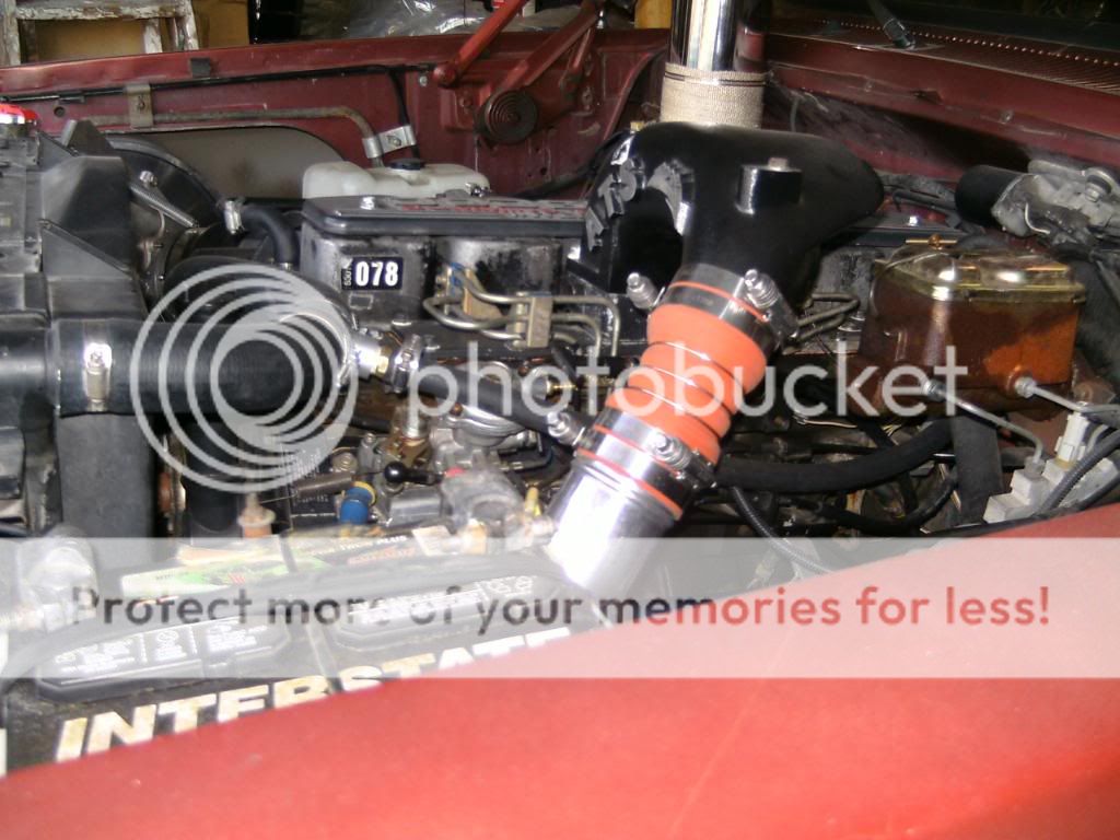

pulltilbroke what all do you have done on the fuel side of things in your videos? I'll get some pictures of my truck up soon as I get a chance. It is almost done besides the hitches front and rear.

Believe it or not in all these vids I was running stock N/IC sticks, DennyT, pump on the verge of runaway, timing on the head and an Aeromotive SS pump through stock lines and filter. I took the Aeromotive off because it had cold weather issues and I replaced it with a Holley Black.
