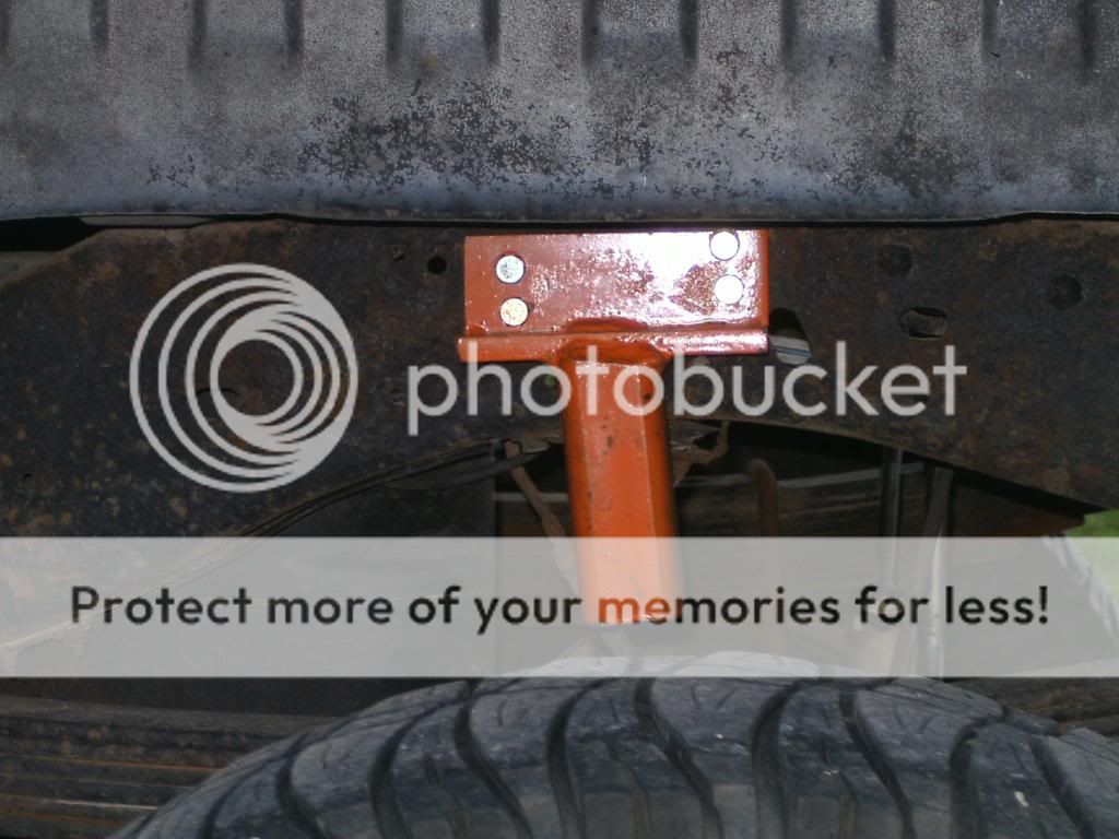

I would build a set of bars front and rear, hitch, rack

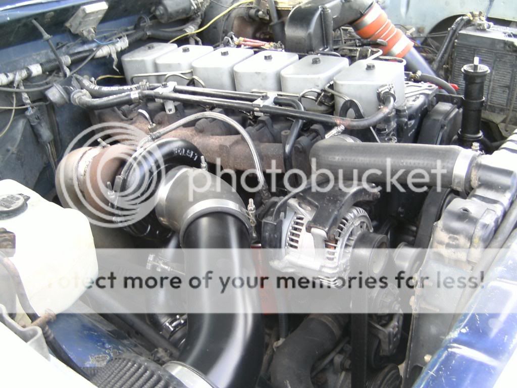

As far as my truck goes its nothing special at all and only makes a bit over 300hp but pull suprisingly well
90 Dodge with a D80,NV4500, Decent single disk (recycled from captainchrysler).
Engine and fueling mods consist of 370,000 mile leaky VE, DennyT,4200(354) spring, pump on the head, Holley Black,Stock N/IC sticks, 2nd gen cooler and tubes, 24v air horn, H1c with a HTT STG IV compressor and a 16 cm housing, I'm sure theres more that I'm forgeting

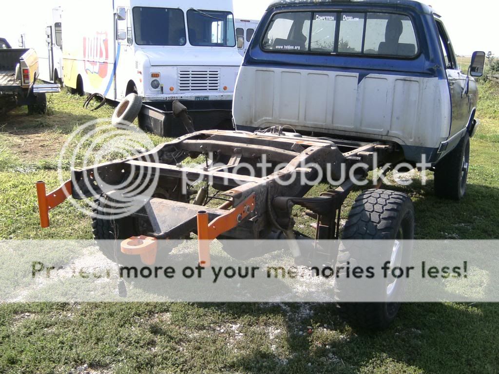

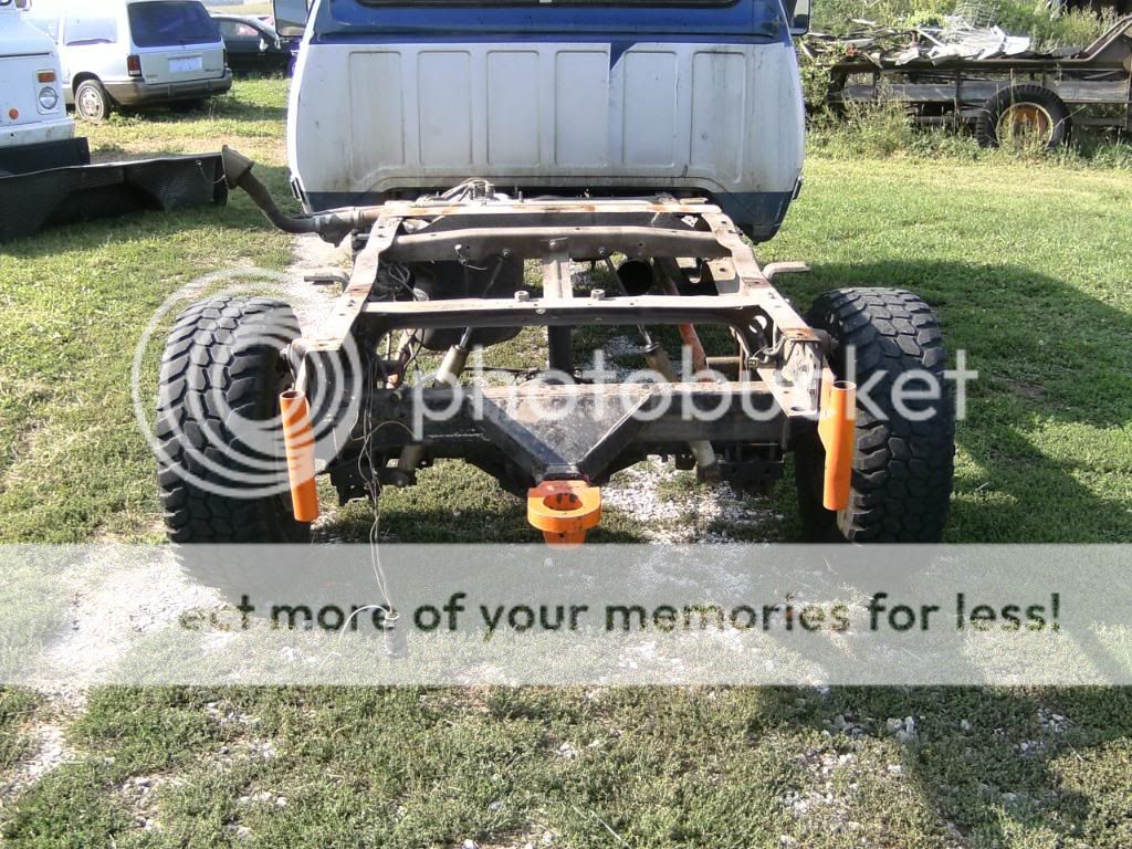

Heres some pics and video of my junk and others to give you some Ideas
Stillsmokins truck
Heres a couple of my hooks from last year.
